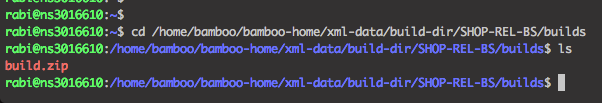

The log shows that the path for artifact is invalid but I can make sure that the path exist. Pelase see the screenshot:

Hi Rabi,
Please check and make sure the user running Bamboo has access to the zip file in that directory.
Hi Edwin,
Thank you for your reply.
Please see the permissions for the build.zip artifact.
As the user and group is bamboo, wouldn't bamboo have access to the file?
Yes, bamboo should have access. Try adding a task to clean the working directory.
So the same configuration is working on another server but not after you moved it?
Cleaned the working directory manually before running the plan. Still no luck.
I have done following:
Added a task to see who the user is, shows bamboo as expected.
Added a task to list files, the build.zip is there as expected.
Added a task to give permission 777 to build.zip.
05-Jan-2018 12:24:35 total 285264
05-Jan-2018 12:24:35 -rwxrwxrwx 1 bamboo bamboo 292109077 Jan 5 12:24 build.zip
05-Jan-2018 12:24:35 bamboo
05-Jan-2018 12:24:35 Unable to publish artifact [build.zip]: the source directory /home/bamboo/bamboo-home/xml-data/build-dir/SHOP-REL-BS/builds/build.zip does not exist.
05-Jan-2018 12:24:35 The artifact is required for down stream Stages and Jobs, build will now fail.
Previously installed bamboo on the same server with internal HSQL database but now decided to move to postgresql so re-installed the bamboo.
Used the same exact scripts and settings.
