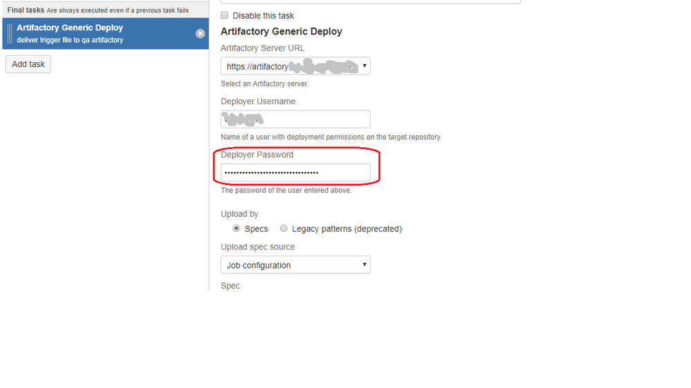

Great answer for masked variables.  However, I tried this solution for task type 'Artifactory Generic Deploy', it does not work. It seems that for this task type, it takes readable password string instead of encrypted form in 'Deployer Password' field.
As we are checking java spec code into source control, it is highly recommended that the readable password should NOT be part of code. So, do we have a way to let this task type take encrypted password? or, alternatively, is there a way to call any existing functions ( like what env var decrpytion does) to decrypt the password at run time? Or maybe there's other better way to handle this case?
'Artifactory Generic Deploy' Task view through bamboo portal UI
Code snippet corresponding to field 'Deployer password'

.put("artifactory.generic.password", "*************") //<------This is where the password is, it takes un-encrypted, plain text form

It's responsibility of plugin developer to store data in encrypted form in DB and decrypt it in runtime. Contact plugin vendor to fix this issue: https://www.jfrog.com/jira/projects/BAP/issues
