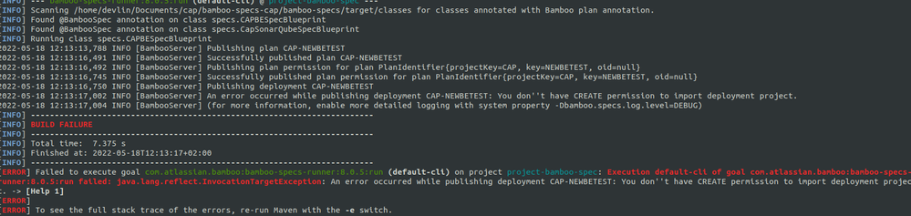

I'm trying to create a deployment plan by command line from mi bamboo specs in java. When I'm trying to create it I get a permission error saying that I don't have permission to create the deployment plan. If I try to create the deployment plan manually through the browser I can do it without problems using the same user.
As info, my user has admin permissions, and the token created to use in the bamboo spec was created with the option to have the same privileges as the user.  I also performed tests using the .credentials file with my username and password obtaining the same error (example in the github link below)
The error is the following:
"Execution default-cli of goal com.atlassian.bamboo:bamboo-specs-runner:8.0.5:run failed: java.lang.reflect.InvocationTargetException: An error occurred while publishing deployment CAP-NEWBETEST: You don''t have CREATE permission to import deployment project. -> [Help 1]"
