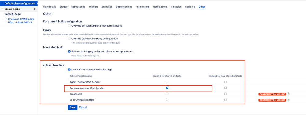

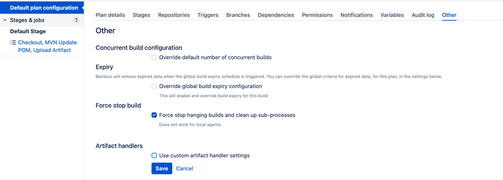

Brightson Macha
August 27, 2025
Please see below screenshot and suggest if that the way to go.
Initial:
When Tick artifact handler:

Shashank Kumar
August 27, 2025
Hello Brightson,
Yes that's the right way to do it, do give it a try and run a new build and a new deployment and see if it helps.
