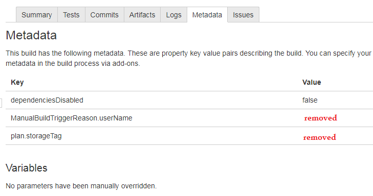

And here is the metadata tab of my build:

I think that's the Metadata tab for the plan. It should be in the metadata tab for the Job. :)
To do that, from the same screen; click the expander on the left hand side of the UI (it looks like a little >) to expand all the Jobs in the Build Result and then select the Job which has the POM Value Extractor > Metadata. Make sure to then scroll all the way down the page to the Variables section.
Dieter Bogdoll
July 10, 2018
Hi Jeremy,
thanks for this tipp. I always have overseen that arrow.
(For me the arrow is on the left side though.)
Thanks a lot,
Dieter
