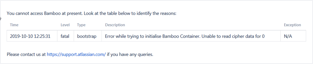

I tried to install Bamboo on my local computer for an evaluation. Unfortunately I got the following error message:
I already use jdk 1.8. So this could not be the problem. If any log files are needed please let me know which one.
I appreciate any help to solve this problem!
Thanks for your help in advance!
Günther
Daniel Santos
October 11, 2019
Hi @Günther Bär
If this is a new installation and you have nothing to lose, please try the following:
  1. Stop the process
  2. Delete the Bamboo home directory
  3. Delete the DB created for Bamboo (in case you configured it with an external DB)
  4. Start the process again
  5. Configure your instance
This problem happens when one of the encryption keys (from DB or filesystem) is not available. It could be an issue caused by an interrupted installation, wrong filesystem permissions when restarting the process with a different user or another issue.
Considering that you have nothing to lose I would just try another installation with a clean environment.
Let me know how it goes. =]

I followed your instructions but unfortunately it didn't work. The same effect as before.
The log file says something like
2019-10-14 09:15:38,794 INFO [AtlassianEvent::0-BAM::EVENTS:pool-1-thread-2] [BambooSmackClient] No IM server specified. Bamboo Smack client not initialised.
2019-10-14 09:15:40,167 INFO [http-nio-8085-exec-15] [JohnsonFilter] The application is still starting up, or there are errors. Redirecting request from '/setup/finishsetup.action' to '/error/errorEvents.action'
2019-10-14 09:15:40,198 INFO [http-nio-8085-exec-13] [AccessLogFilter] admin GET http://localhost:8085/error/errorEvents.action?next=%2Fsetup%2Ffinishsetup.action 380029kb
or
2019-10-14 09:15:38,794 ERROR [finishsetupBackgroundThread] [FinishSetupAction] Failed to set up Bamboo
java.lang.RuntimeException: Failed to upgrade
at com.atlassian.bamboo.upgrade.UpgradeLauncher.upgradeAndStartBamboo(UpgradeLauncher.java:150)
at com.atlassian.bamboo.ww2.actions.setup.FinishSetupAction.execute(FinishSetupAction.java:41)
at sun.reflect.NativeMethodAccessorImpl.invoke0(Native Method)
at sun.reflect.NativeMethodAccessorImpl.invoke(Unknown Source)
at sun.reflect.DelegatingMethodAccessorImpl.invoke(Unknown Source)
at java.lang.reflect.Method.invoke(Unknown Source)
at ognl.OgnlRuntime.invokeMethod(OgnlRuntime.java:899)
at ognl.OgnlRuntime.callAppropriateMethod(OgnlRuntime.java:1544)
at ognl.ObjectMethodAccessor.callMethod(ObjectMethodAccessor.java:68)
at com.opensymphony.xwork2.ognl.accessor.XWorkMethodAccessor.callMethodWithDebugInfo(XWorkMethodAccessor.java:98)
at com.opensymphony.xwork2.ognl.accessor.XWorkMethodAccessor.callMethod(XWorkMethodAccessor.java:90)
at ognl.OgnlRuntime.callMethod(OgnlRuntime.java:1620)
at ognl.ASTMethod.getValueBody(ASTMethod.java:91)
at ognl.SimpleNode.evaluateGetValueBody(SimpleNode.java:212)
at ognl.SimpleNode.getValue(SimpleNode.java:258)
at ognl.Ognl.getValue(Ognl.java:470)
at ognl.Ognl.getValue(Ognl.java:434)
at com.opensymphony.xwork2.ognl.OgnlUtil$3.execute(OgnlUtil.java:401)
at com.opensymphony.xwork2.ognl.OgnlUtil.compileAndExecuteMethod(OgnlUtil.java:453)
at com.opensymphony.xwork2.ognl.OgnlUtil.callMethod(OgnlUtil.java:399)
at com.opensymphony.xwork2.DefaultActionInvocation.invokeAction(DefaultActionInvocation.java:438)
at com.opensymphony.xwork2.DefaultActionInvocation.invokeActionOnly(DefaultActionInvocation.java:293)
at org.apache.struts2.interceptor.BackgroundProcess$1.run(BackgroundProcess.java:55)
at java.lang.Thread.run(Unknown Source)
Caused by: java.lang.IllegalArgumentException: Unable to read cipher data for 0

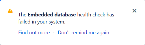

Thanks a lot! Now I could finish the installation but afterwards I got the following message in Bamboo:
I guess there is something to improve in the installation process!
Daniel Santos
October 18, 2019
Hi @Günther Bär
I'm very glad that you were able to finish the installation.
I found this issue reported, but it was closed with a fix in our docs:
This was the document changed:
Regarding the embedded DB health check, this DB should only be used for evaluation purposes. Only instances with external DBs should become production ones. That is why the health check fails.
