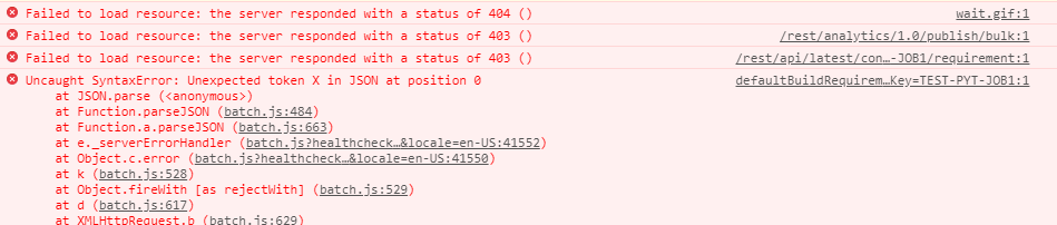

I'm facing an error when trying to add requirement to my build plan.
When I try to add requirement, it just infinite load, and in my console I see this error :
When I try to reach this link directly, I have no issue, it just print a empty array in text plain.
I also look in my bamboo log and see this when I add requirements.
[XsrfResourceFilter] Additional XSRF checks failed for request: http://BAMBOO_URL/rest/api/latest/config/job/TEST-PYT-JOB1/requirement , origin: BAMBOO_URL , referrer: BAMBOO_URL/build/admin/edit/defaultBuildRequirement.action , credentials in request: true , allowed via CORS: false
