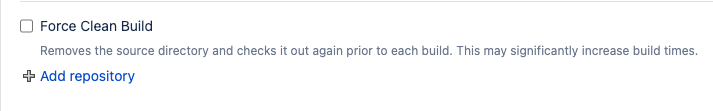

You have mentioned that the script task is cleans the build directory, so we'll need to stop that. To do that you can go to the script task in your plan configuration and uncheck the option of "Force clean Build", see below
Let me know if this works for you.
