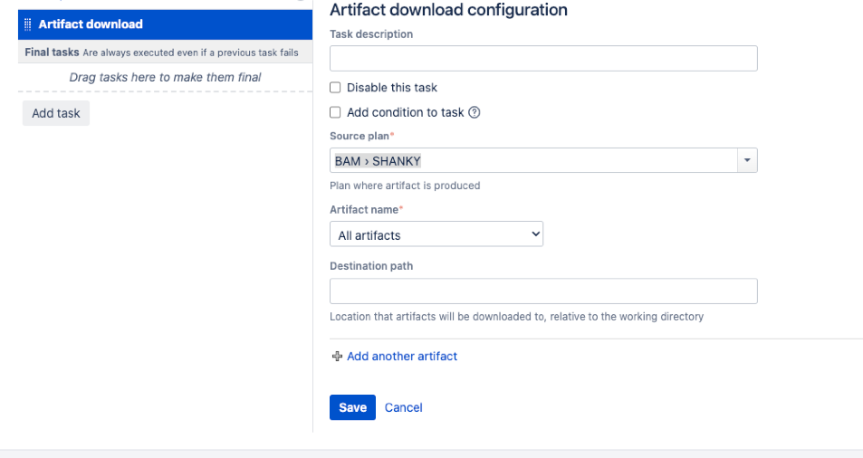

You can use the Artifact download task to achieve the same and choose the plan from where you want to download the task, see the example below
YAML Specs code
- artifact-download:
artifacts:
source-plan: BAM-SHA
You have said upgrading to Bamboo v.8.1.2 should be sufficient, hope you are talking about the above 2 solutions.
