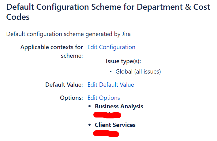

How is the department field (especiall the owner) configured? Could you give a screenhot for more insights to that?
I´m pretty sure that processing through your departments with if/else might take a lot of time :-/ Something that came to my mind in this case (without knowing further details, the field configuration, etc.... so it´s more a guess) are smart values and (maybe) variables. Did you think about that way or might that be something that sounds feasable?

Hello @Stefan Salzl
Each Department is a parent value in the cascade field.
The owner is applied from the automation rule.

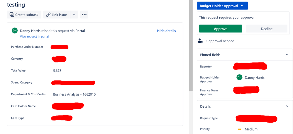

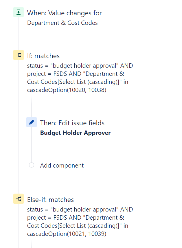

Danny
February 19, 2022
I’ll upload a screenshot of the automation rule.
thanks for sticking at this.

Danny
February 19, 2022
Like Stefan Salzl likes this
Stefan Salzl
February 20, 2022
Hi @Danny ,
as far as I can interpret your setting I can just make a guess of an idea but maybe this is a feasable way:
From my point of you view I don´t see a way without if/else either =/ Still I think performance can be increased:
  1. status check
    status = "budget holder" AND project = PROJ AND "Department & Cost Codes[Select List (cascading)]" in cascadeOption(10020)
    as far as the reference issue is the trigger issue the status check could be done immediatly after the trigger. As far as I got it the rule should only run for issues in status "budget holder"
  2. value check (cascade field)
    As it seems for me within each IF block it´s still a static validation of a value of the cascase list fields. Would it be feasable to check those fields/their values via smart values (which i guess is more performant than executing a jql)?
    Parent:
    {{issue.fields.Cascade.value}}
    Child:
    {{issue.fields.Cascade.child.value}}
    so if value of parent = 'xxx' and value of child = 'yyy' --> action (budget holder = 'abc')
Hope I got your setting and requirements as correct as possible. If not and you would like to stick to the topic I would have one last suggestion (if possible) to also send a screenshot of how the issue looks like.
Looking forward to your feedback.
Best
Stefan
