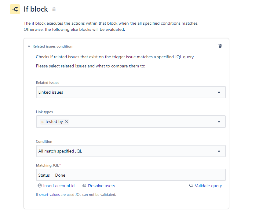

Best I can think of is run a scheduled job with JQL of:
issueLinkType in ("Caused By") AND status = Done and resolution = Deployed
Then use an "if else" along the lines of:
Note: I used "is tested by" as the link type, but you would use your "Caused by" one.
Then use the "edit Issue" action to configure your step 3.
Worth a try???

Curt Holley
October 26, 2020
@Russell Zera I think it could.
That was why I just opted for a schedule, as I couldn't think of another way to "trigger" the event.
I don't think it matters how often you run the schedule. What matters is how many updates it is likely to do per "schedule", as that is where the grunt is.
Plus, whether you intend it to be a single project, Multi project or Global automation. Particularly f you are not a premium customer and have to watch your Multi project/global executions.
