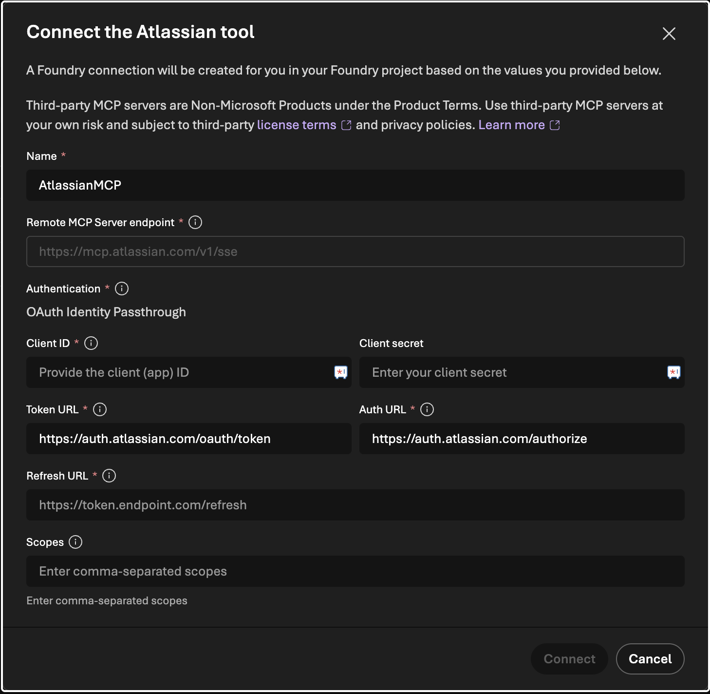

It the new Microsoft Foundry, they allow us to use the Remote MCP of Atlassian.
I'm trying to configure it, but with no success.
This is the configuration panel:
I've tried to create an app via the Atlassian developer and input the client id and secret. Also, gave the scopes of read:jira-user, read:jira-work and offline_access.
Then, when trying to give consent, it opens OAuth flow, but I'm getting "Unauthorized" errors afterward.
Did someone got a success to configure it or have an idea how to configure it correctly?

Also trying to achieve this and am wondering if you or anyone else seeing this have manged to succesfully use the official mcp via Microsoft Foundry? I am getting the authentication popup and a "login succesful" but then immediately:
"ErrorAuthentication failed when connecting to the MCP server: https://mcp.atlassian.com:443/v1/sse: Response status code does not indicate success: 401 (Unauthorized).. Verify your authentication headers. Suggestions: First verify the required permissions. If the access token is expired or revoked, recreate the connection. If this connection is shared by other users or workflows, recreate it carefully to avoid disruption."
I have made sure that the scopes set up in Atlassian OAuth are matching the ones i specify in Foundry. Adding the tool in Foundry generated a redirect url that i added as callback url in Atlassian OAuth. However I wasn't quite sure what to put as "refresh url" in the Foundry configuration, I simply pasted "https://auth.atlassian.com/oauth/token" from the "Token url" field. Maybe that was wrong, or does Atlassian MCP not support the Foundry agent yet? Anyone knows?
I believe I've tried exactly the same as yourself, and face exactly the same issue.
I've tried various approaches with just a single scope, having tried classic and granular too.
We receive the authentication popup and that works, but can't get any further than that.

I've stumbled across exactly the same problem (connection and oauth consent work, in playground when beeing incorported ((..)
It seems like in the Microsoft Foundry Next Gen the Authentication Workflow is not implemented properly for the current Atlassian Setup.
The Atlassian MCP Server is working with VS Code and we could also facilitate to use with Custom Code and manual Authentication handling => however for productive use, that's not a valid option.
I'll also try to post in other forums on Microsoft side and retry in some weeks.
