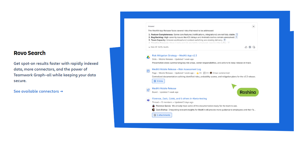

HI @Ibby , thanks for the information provided.
So do i get that right - the ROVO Search exposed through the Atlassian Rovo MCP Server is using a different technical baseline than ROVO Search within Atlassian products. You wrote that the former is using text based search not vector. Does that mean, that it is "just kind of an API wrapper" around standard API calls like issue search by JQL like also in the solution Hernan outlined - totally without the nice teams graph integration vector search etc.? I'd personally find the naming Rovo MCP Server a bit misleading then in the current status.
ROVO Search in the Atlassian Rovo MCP Server
Using Rovo search and fetch in the Atlassian Rovo MCP Server | Atlassian Rovo MCP Server Cloud | Atlassian Support
ROVO Search
Search | Rovo | Atlassian Support
Explore Atlassian Rovo: Search, Chat, and Agents | Atlassian
Being able to use Rovo Studio Agents from "outside" (supporting A2A?) would definitely be a good solutions (also independently) - I did not investigate, but is there a way to get that done now already?

That's not what I meant. The Rovo Search tool in the MCP Server is using Rovo Search "That is exactly the same you use in product experience".
So in total the MCP Server has Rovo Search, JQL and CQL tools.
Sorry, what I meant by not support vector here, is the Rovo Search tool input is a string not an embedding. So Rovo search tool will be doing all the magic here similar to the Rovo Search in products.
