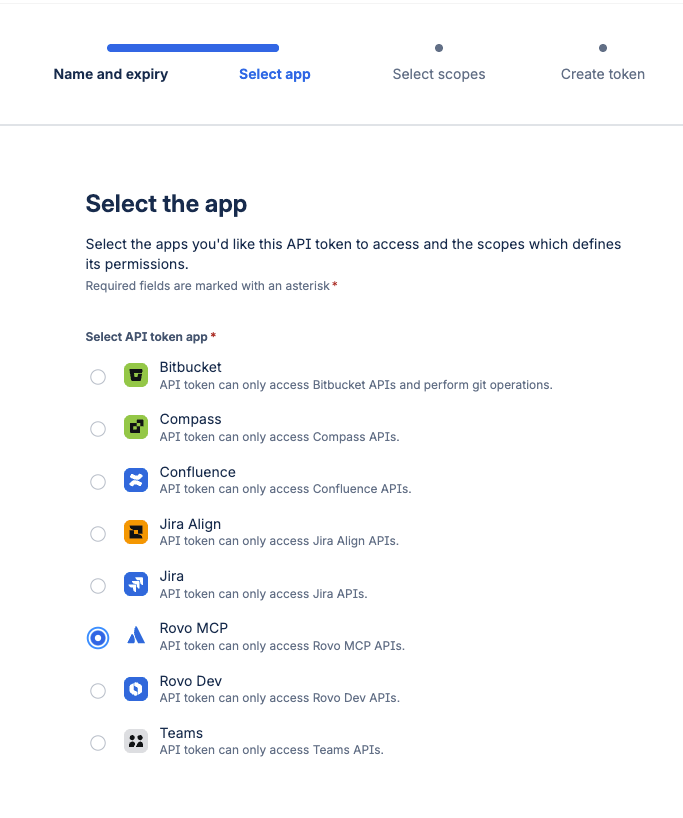

Rovo MCP Scoped Token

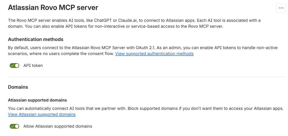

Org Admin Setting to be enabled

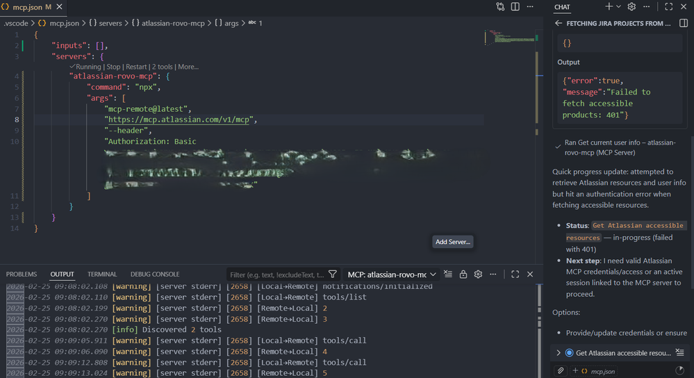

Hi, I'm having trouble connecting to the MCP server, I've make sure to follow every steps mentioned in the guide.
  2. Setting up the API token
Are there any missing steps?
Thank you
Ibby
February 24, 2026
Hey @bondansebastian
Did you create a new Rovo MCP Token? when 2 tools are showing it either means token encoding issue or it's not using Rovo MCP scoped Token.
Like bondansebastian likes this
bondansebastian
February 24, 2026
Ah, I used a previously created token which is probably is not a Rovo MCP token. It works now! Thanks for the help.

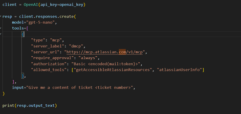

Did something change since yesterday? I am creating OpenAI agent, that would connect to Rovo MCP (below basic "demo"). I created API token, based64 it according to instruction.
But since yesterday morning I am getting (openai.APIStatusError: Error code: 424 - {'error': {'message': "Error retrieving tool list from MCP server: 'dmcp'. JSON-RPC 2.0 error code: -32601", 'type': 'external_connector_error', 'param': 'tools', 'code': 'mcp_protocol_error'}}).
Could you give me a hint, if I am doing something wrong, or did something change?image (2).png
Ibby
March 5, 2026
Hi @Michał Maciaszek
What type of token did you create, is it a scoped token? I did a quick test and it's working for me and few team members too.
Can you share your pip requirement too? Also non of the allowed tools in your script can get a Jira Issue.
Michał Maciaszek
March 5, 2026
Edit:
I managed to fix it, I should have used:
"headers": {"authorization": "Basic <encoded stuff>"}, instead of just "authorization". But I could swear, that two days ago I didn't have to do this.

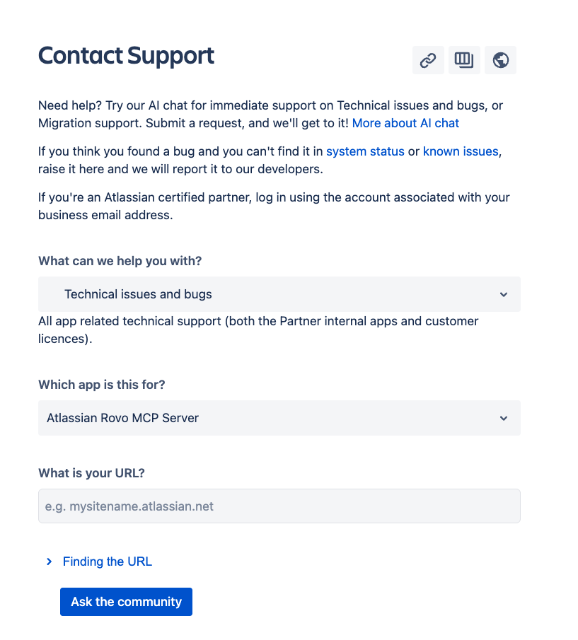

Hello @Juan Pablo Gavagnin
We tried investigating the error that you shared but even with replicating your scope we did not get an error and we were not able to reproduce this issue.
Would you mind filing a support ticket so that we can get some logs and get some more information about how you configure your scope? That will allow us to help solve this issue in a much better way for you.
File a ticket here like this: https://support.atlassian.com/contact

Unless, there is something wrong I am doing.
Let me know
Thanks

The prefilled token URL is meant as a convenience path for the full MCP tool set, not as a least-privilege template.
MCP does span multiple Atlassian products, so the full experience needs scopes
across apps.
For a narrower setup, create the scoped token through the manual scope-selection path , select "Rovo MCP" and grant only the products/actions you want.
MCP should then expose only the tools compatible with those scopes, and the underlying user's product permissions still apply. If you omit write scopes, write tools should not be available.
On classic API tokens: correct, use scoped API tokens with the required scopes. Product permissions are still enforced, but classic API tokens do not provide the scope
signal MCP needs.
