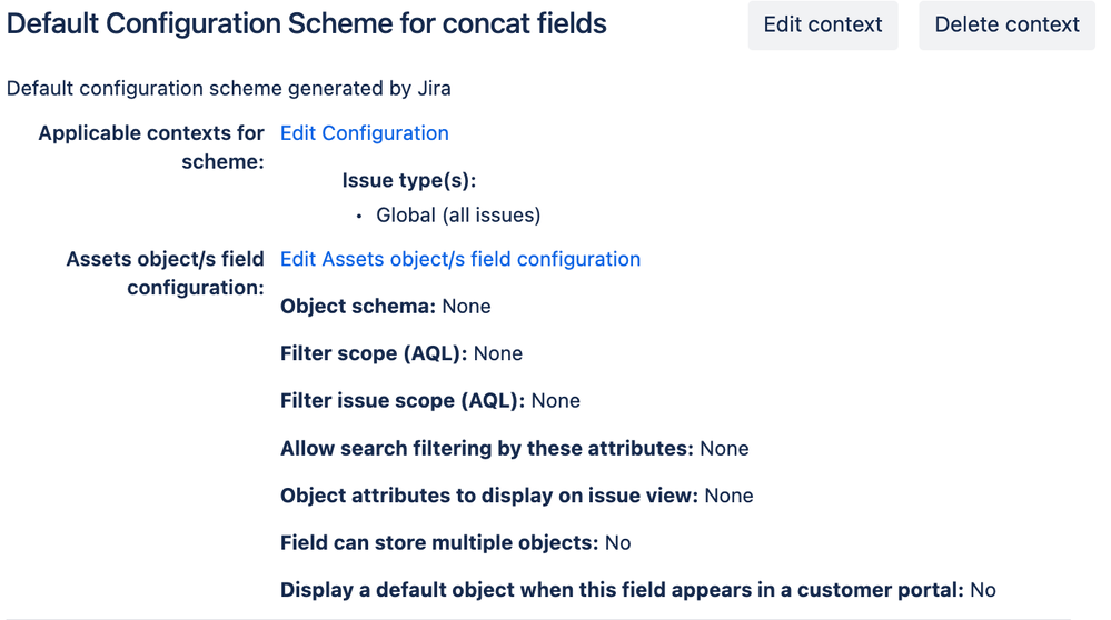

Welcome to the community, to implement a concatenated field
In your JSM project, add a new custom field of type "Assets objects".
Configure the field:
 Select the desired asset object schema,Within the "Filter Work Scope (AQL)" section, write an AQL query to specify which attributes from your asset objects you want to include and how to join them together using the "CONCAT" function.
Example AQL query for a concatenated field:CONCAT(asset.name, ", ", asset.serialNumber, ", ", asset.location)

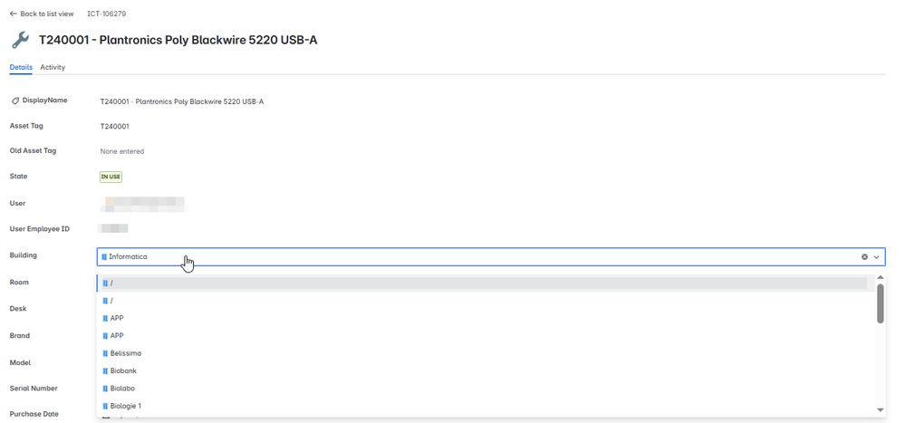

Hi @Pasam Venkateshwarrao
Thank you for your response. I found the suggestion you did, and this works great on JSM forms. But I want to use it in the assets itself.
ex where I want to use it (see Building field):

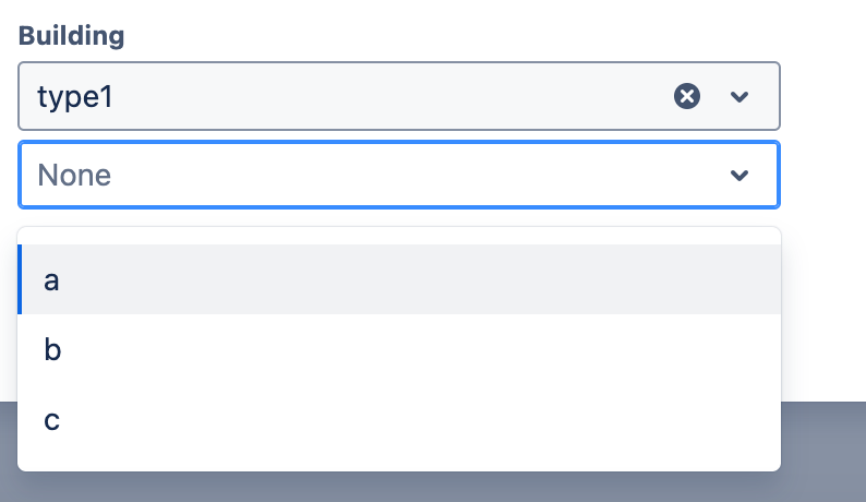

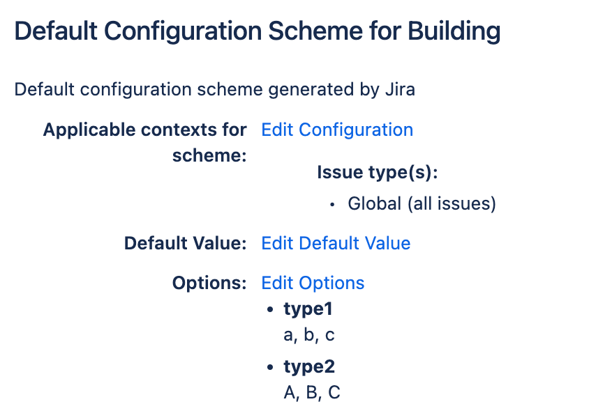

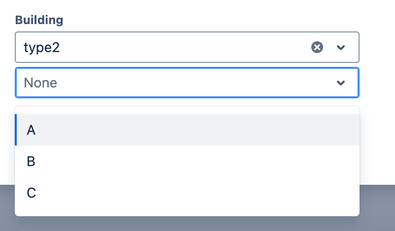

March 15, 2025
@Vicky Pelgroms then you can create custom field Building as a "select List (cascading)" type then it will show like this
Screenshot 2025-03-16 at 12.03.13 AM.png Screenshot 2025-03-16 at 12.03.01 AM.png Screenshot 2025-03-16 at 12.02.38 AM.png
