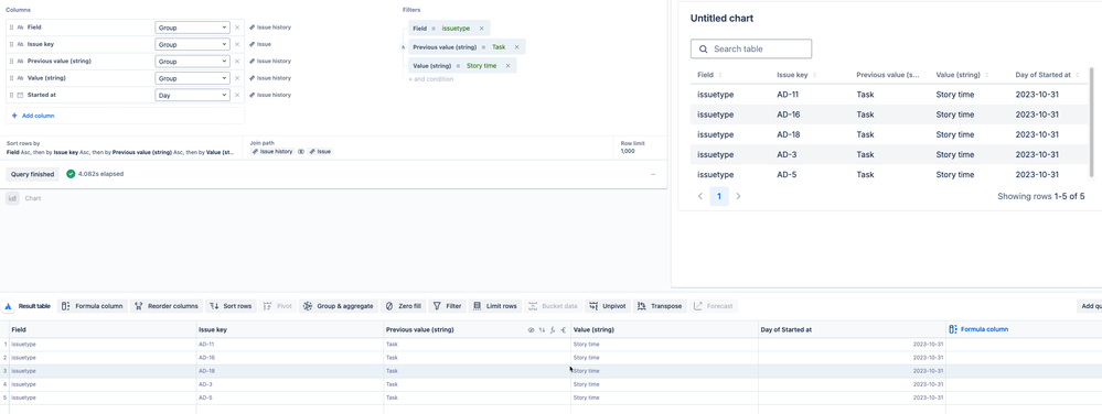

Hey @Broussard, Anna ,
Thank you for your question. We keep track of field values in the Issue History table. If an issue undergoes a transition from one issue type to another, you should look for the "issuetype" field in the "Field" column and compare the previous and current values.
Here's an example of how you can approach this. In this example, I'm filtering based on both the previous and current values. You can adapt this method to fit your specific use case.2025-03-10_19-18-50.png
Let us know if you have any questions.
Thanks,
Arumugam
Broussard, Anna
March 18, 2025
Hi Arumugam, I was able to use the method you suggested. It's a little more work to get the information I need (to get both the transition from an existing issuetype as well as all new stories), but do-able. Thanks for the suggestion.
