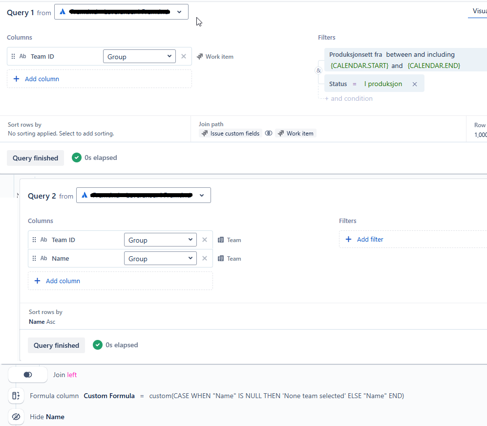

I’ve created a multi-select dropdown controller that shows all teams that have made a delivery. To be able to select “None team selected”, I made two queries and joined them with a left join. I see that I could also do this directly by overriding the SQL, but my custom code disappeared when I switched back to the visual mode, so I did it this way instead. I also added a custom field to get a value where Team ID is null.
Question 1:
Is this the right way to handle a left join without editing the SQL code directly? Are there any better/best practices for doing this?

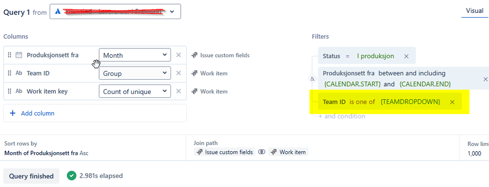

I have connected the controller to a chart with the filter “Team ID is one of {TEAMDROPDOWN}.”
This works fine for all values except when I try to select “None team selected.” I think this is because it can’t match null with “is one of"?

1. Is your left join approach in Visual SQL best practice?
Your method—using two queries and a left join in Visual SQL to include a “None team selected” option—is a common workaround, especially since custom SQL edits are lost when switching back to Visual mode. This approach is valid and often necessary when you want to surface NULLs (e.g., teams with no delivery) in a dropdown without writing raw SQL. For more on best practices with dropdown controls and key-value pairs, see:

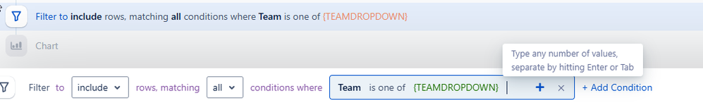

I went with Workaround 1 by creating a custom field that replaces NULL with a value like "None", and then used a custom filter component to filter on that. It’s working well.
