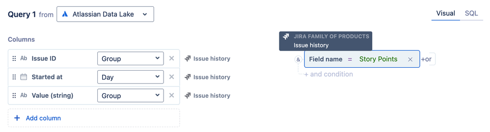

Hi @Broussard, Anna you'd probably want to use the Issue history table to capture when the story points were added to an issue. The screenshot below is an example of which columns you could include from the Issue history table to gather the day when the story points were added to an issue.
Then, you'd only need to adjust your chart to use the data from this query to calculate the burnup with your story point values.

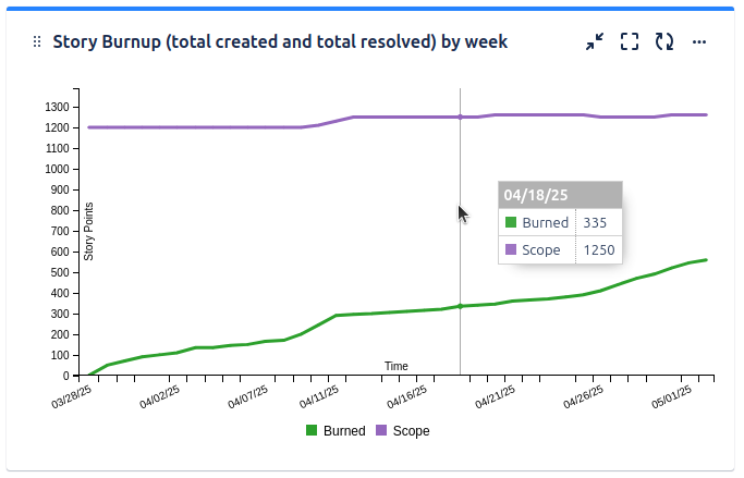

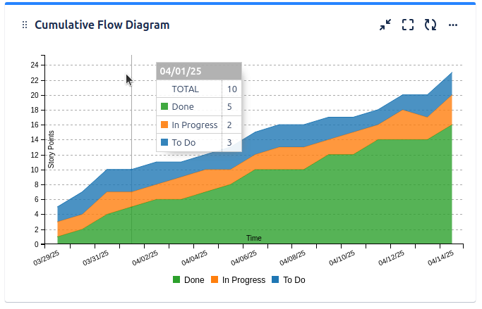

Hi @Broussard, Anna,
I am not very familiar with the Analytics, but could eventually try using a cumulative chart or stacked Areas, by Story Points.
If you don't manage to figure it out in Analytics, you could look for Jira apps on Atlassian Marketplace that provides this type of chart.
If you consider the idea of using an app, this can be easily achieved by using some of the gadgets offered by our Great Gadgets app.
Release Burndown Burnup Chart gadget - lets you generate the burnup. All you have to do is to configure it with a filter/JQL that returns your issues, calculate by SPs, set the timeline and group data by 1 week.
Cumulative Flow Diagram gadget - lets you generate a cumulative stack area chart based on the story points of the issues from filter/JQL, grouped weekly and split by status category.
