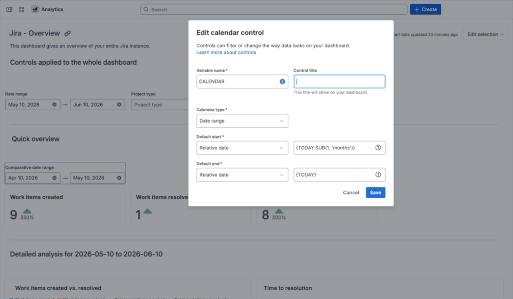

Add a control title directly
You will no longer need to use the Content editor to create a title for your control. You'll be able to add a control title directly from the control form.
Note about the new controls: The height of all controls will be increased to accommodate the new control titles. As a result, the layout of your existing controls may look slightly different after June 22, 2026. You may need to manually adjust the layout of your controls to suit your preferences.

  1. Select Control > Calendar from the dashboard sidebar.
  2. Optionally, add a title to your control.
  3. For Calendar type, select Date range.
  4. Edit the Default start and end dates using fixed dates, or use a combination of relative date variables and date and time functions for dynamic filtering.
  5. Select Add, then place the control anywhere on your dashboard.

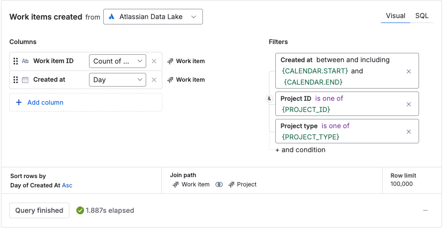

To connect your Calendar control to a chart using a visual mode query:
  1. Open the chart editor by creating a new chart or editing an existing one.
  2. In the Filters section of your visual mode query:
    1. Add the date column you want the control to filter.
    2. Select the filter operator (most people use between and including).
    3. Reference your control using its dashboard variable name:
      • If the "Data type" is Date, use {CALENDAR_NAME}
      • If the "Data type" is Date range, use {CALENDAR_NAME.START} and {CALENDAR_NAME.END}
      • Replace CALENDAR_NAME with the dashboard variable name of your control.
  3. Select Run query, then Save to dashboard.

Step 2 — Connect your Calendar control to the area chart:
  1. Hover over the chart and select More actions > Edit chart.
  2. In the Filters section, add your date column and select between and including as the operator.
  3. Use {CALENDAR_NAME.START} and {CALENDAR_NAME.END} to reference your Calendar control.
  4. Select Run query, then Save to dashboard.
Once you have configured your "Calendar" control, you will be able to remove your existing "Date slider" from the dashboard.
