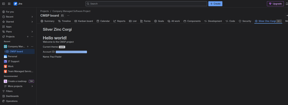

Here are my key learnings ๐Ÿ‘‡

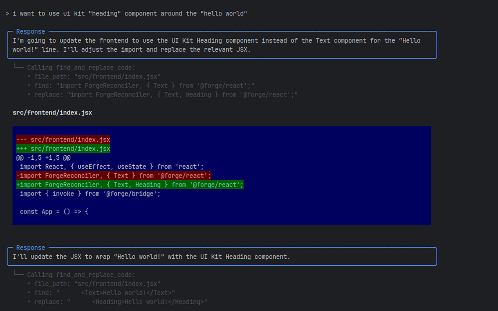

๐Ÿ‘ What worked really well
  • ๐Ÿ’ฌ Explanations: The agent explained every step it took and even suggested next actions.

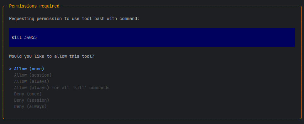

  • โœ… Permissions: It explicitly asked for approval before writing code.

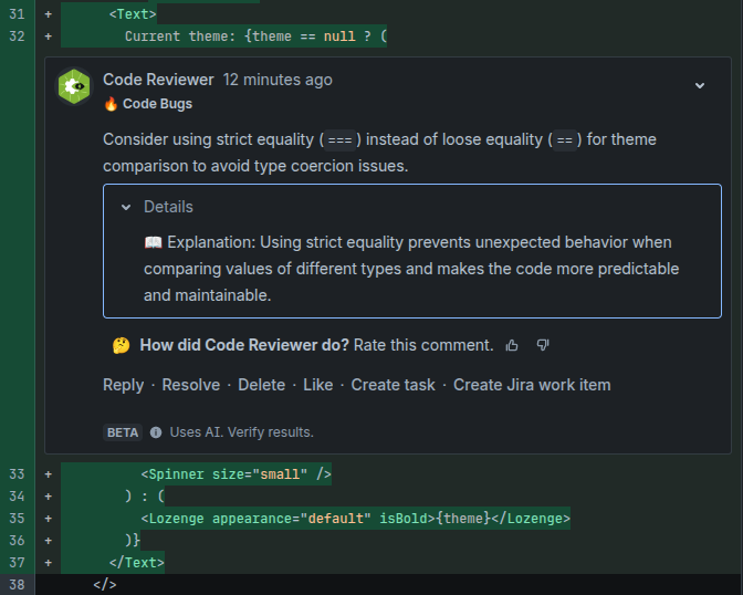

  • ๐Ÿค Code improvements: It suggested meaningful improvements โ€” and combining this with the Rovo PR Reviewer was a great match.
