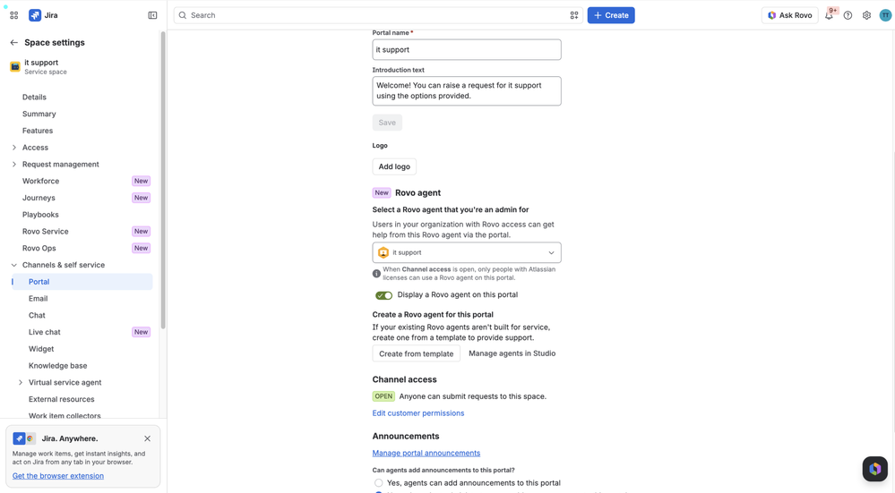

Steps:
  1. In your JSM project, go to Project settings > Channels & Self-service > Portal.
  2. Select Create from template. Rovo will generate an agent with your project's name, instructions, knowledge base, and skills already configured.
  3. Select Test to preview how your agent responds. Try a few common questions your users typically ask.

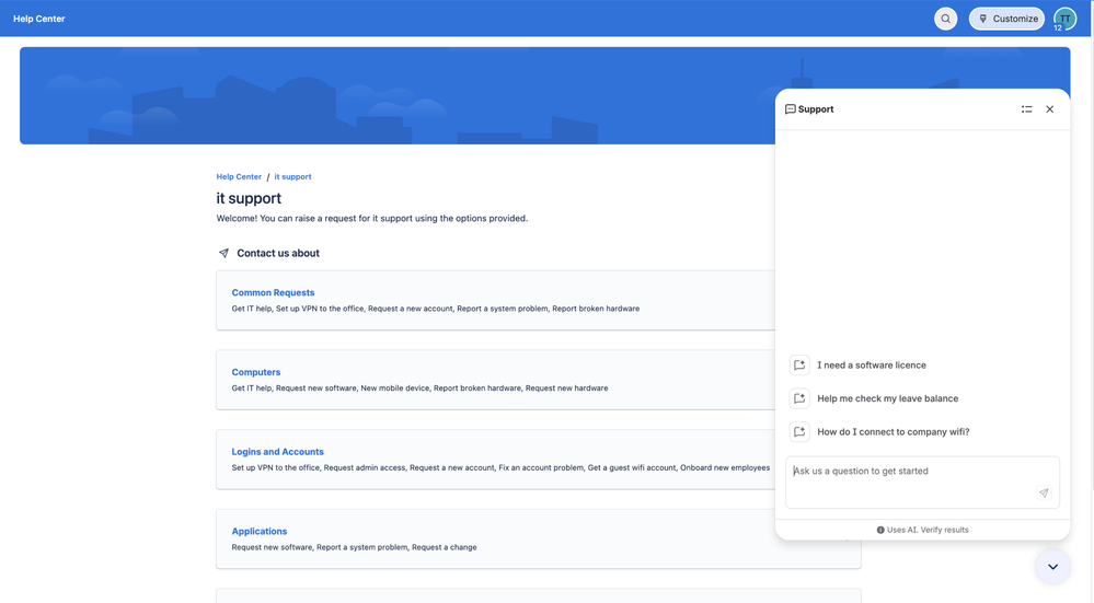

  4. When you're satisfied with the responses, select the toggle to make the agent live in your JSM Portal.
Screenshot 2026-06-18 at 3.15.12 pm.pngScreenshot 2026-06-18 at 3.15.39 pm.png
Your portal help-seekers will now be greeted with a widget powered by your Rovo agent Celebrate
  2. Under Rovo agent, select your agent from the dropdown.
  3. Select Activate.
Things to know:
  • You can only add one agent per JSM Portal, but the same agent can serve multiple Portals.
  • If you created your agent using the template, it's already pre-selected and ready to activate
