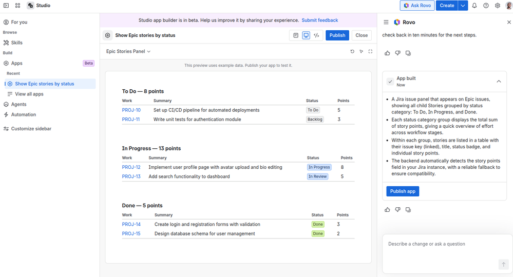

The first stretch is genuinely delightful. I described what I wanted, "a Jira panel that groups an Epic's stories by status and sums their story points", and a couple of minutes later it was running on a real issue, with a real app id, installed on my dev site. No scaffolding, no boilerplate, no CLI.
Then the small magic. I clicked a column in the live preview, typed "swap these two", and it rebuilt just that piece. When a build broke, I pasted nothing but the bare error message and it found the fix. When I told it something was wrong, it reconsidered and corrected itself instead of digging in. I asked it to handle the failure case for an unreliable API, and it added neat per-row fallback states so one bad call never took down the panel. There are thoughtful touches too: a desktop notification when a build finishes, a clearly labeled "this is example data" in the preview.

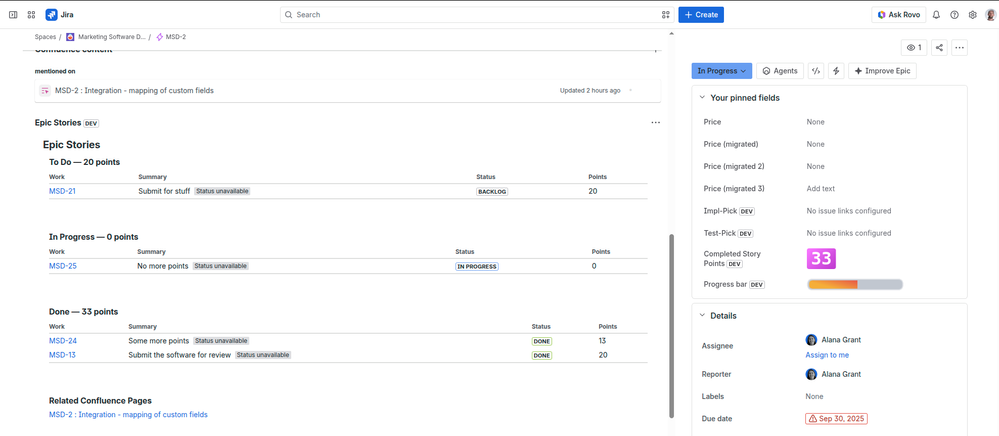

The interesting part of any expedition is where the trail markers thin out, and for me that was the push toward production. I added an external status API. Then I made the Jira panel also pull in related Confluence pages, which quietly turns a single-product app into a cross-product one. And a pattern emerged that is worth sharing with fellow builders: things that looked finished sometimes weren't.

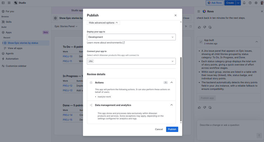

A few examples from my notes. The builder happily published an app whose local build was actually failing its type-check. The changelog it generated once described a feature that didn't exist in the code. A new permission, one that lets the app send data to an outside domain, arrived through a small, collapsed line in the publish dialog without much fanfare. And while wiring up an API key, I got a useful reminder to keep secrets out of code, which is exactly right, and then a prompt to paste the key into the chat, which is exactly the thing to be careful about. None of these is fatal. All of them are the kind of thing a beta smooths out over time. But together they taught me where to keep my eyes.

Notice the governance moments. New scopes and new egress are real decisions. They can slide by quietly, so it is worth pausing on the publish dialog and actually reading what you are approving, especially anything that sends data outside Atlassian.

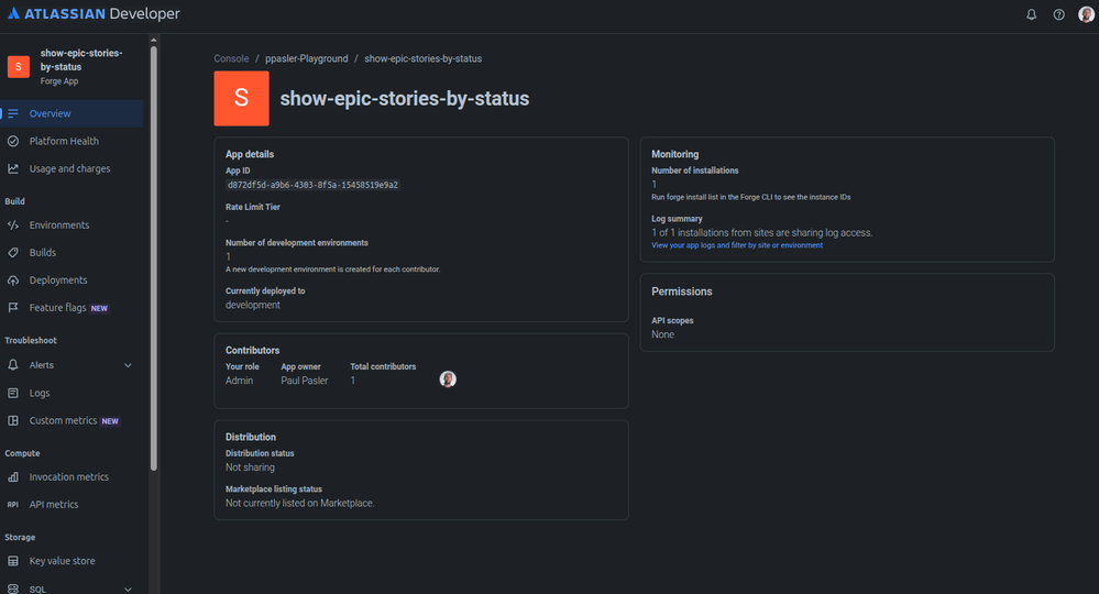

The Atlassian Developer Console

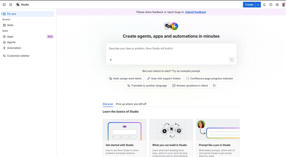

It is a great way to enable non-technical domain experts to write their own prototype Forge apps, without having to know all the details about programming. Unlike normal vibe coding, Studio feels like a part of the Atlassian ecosystem and adds some extra sugar on top (e.g. the live preview).
