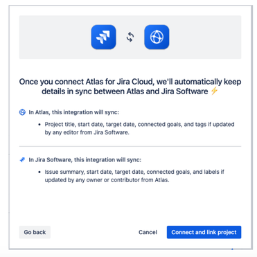

Carlos Garcia Navarro
May 4, 2024
Yes, when connecting the Atlas project to the Jira issue, goals (among other fields) get synchronized:
