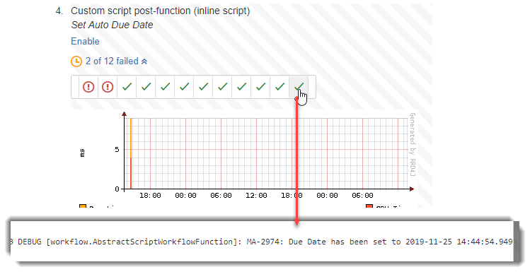

Leonard Chew
November 22, 2019
A summary of the last 15 executions can be seen if you expand your postfunction.
Everything you log can be seen in the log section.
