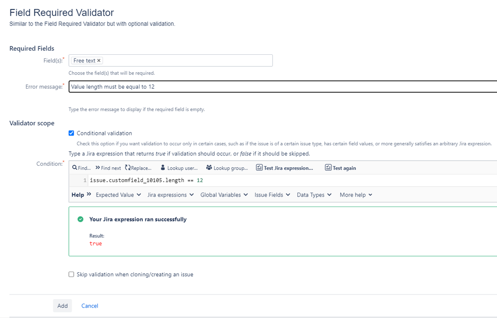

I attached an example image showing a sample validator to fit your use case. You can use the Issue Fields dropdown to get the id of the custom field and then add you desired condition.
You can check out this documentation for more information or please contact our support if you have any other questions about this query.

i have tried the suggestion that you shared above, but it seems not working, i think because the conditional validation is for condition that must be true to make the validator work, is there any possible ways to make it happen?
Thankyou
Prosper Agwegiokhe
August 21, 2024
Hi @Nicolas Andika
Apologies for the late response, and you are correct, the conditional validation must be true for the validation to work.

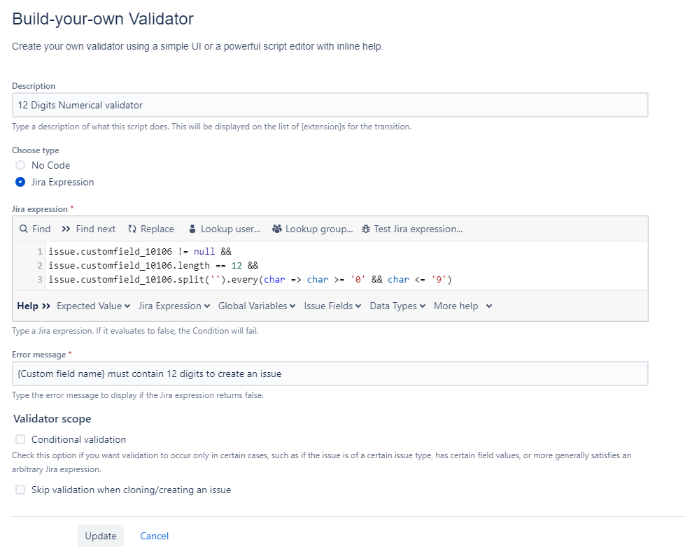

The approach to take would be to "Build-your-own Validator". I tested with this function:
issue.customfield_10166 != null && issue.customfield_10166.length == 12 && issue.customfield_10166.split('').every(char => char >= '0' && char <= '9')
and it worked as expected. It is also worth mentioning i tested this with the short text (plain text only) custom field as it doesn't seem to work with rich text.
Please try this out and let me know if it resolved your issue.
