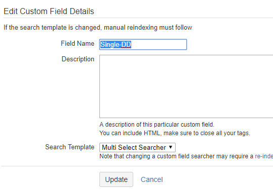

This event triggers when a customfield's configuration is updated, as well as the description of the field or the field name.
I think that you wanted this to detect a change on the value of a customfield in a create or edit screen. Maybe you can do this with a watcher or a behaviour.

I assume the screenshot shows me how the mentioned event works because I dont understand how that screenshot will help me with my question?

Yes, the screenshot just shows you the event that I said.
