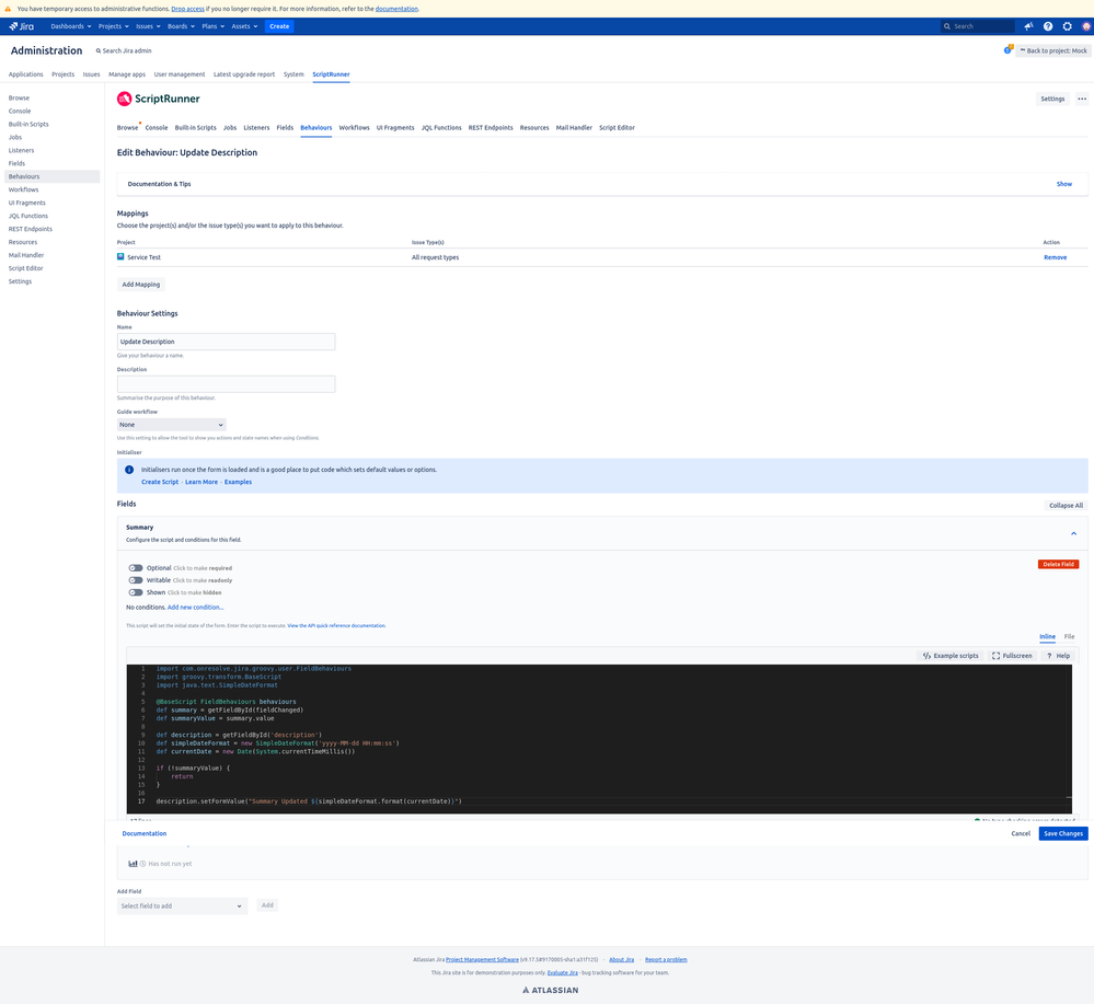

Below is a screenshot of the Behaviour configuration:-
Note: The Behaviour configuration above is explicitly configured for a Service Desk / JSM project and not a Jira Software Project. Please ensure it is configured the same in your environment.

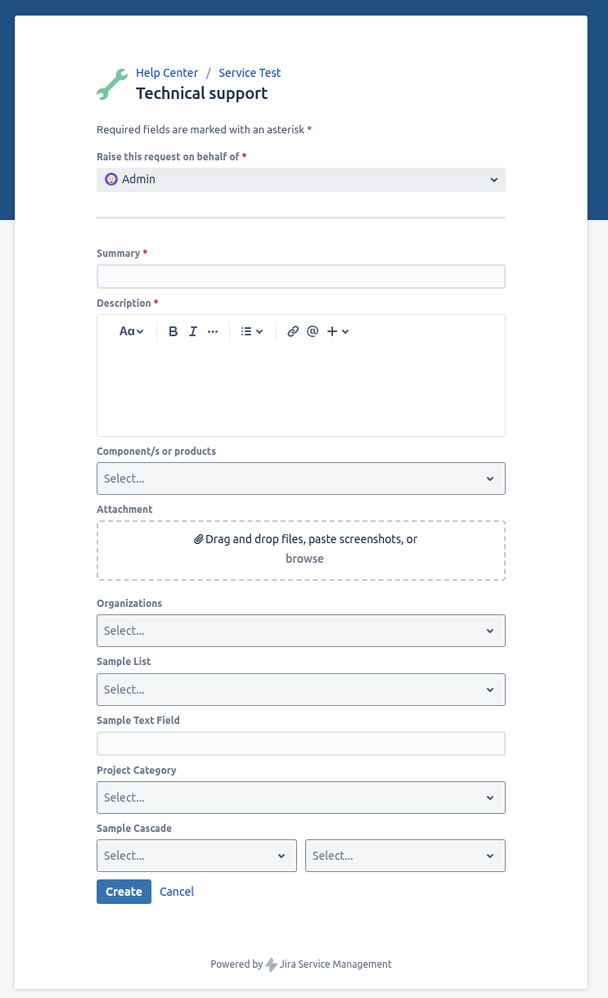

1. When no value is set to the Summary, the Description field is empty.

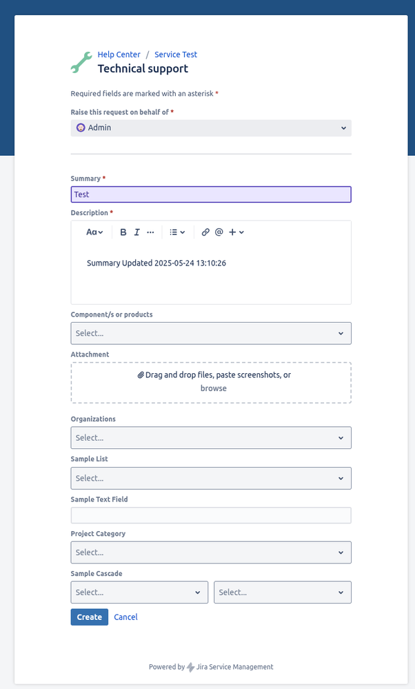

2. Once a value is added to the Summary, the Description field is updated with a timestamp.

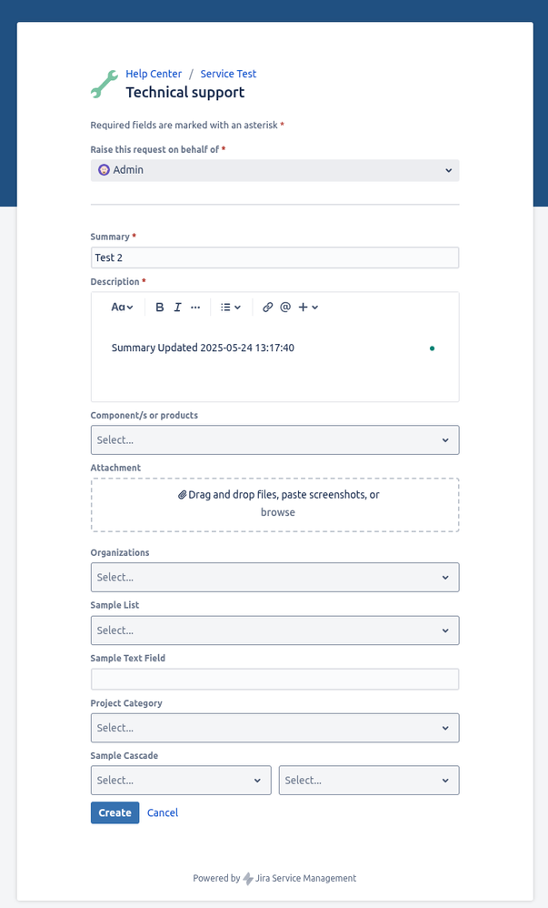

3. If the Summary is updated, once again, the timestamp in the Description field is updated accordingly as shown in the screenshot below:-

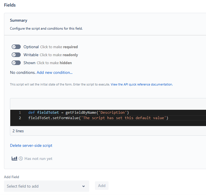

To the best of my knowledge, it's set up as a server-side script for the Summary field. I'll attach a screenshot of what I have.
I'm just going into the customer portal for the project, opening a new request, and filling in the fields there. Is there an extra step I need to take to have that trigger the Behaviour? I've been reading examples of how to set field default values based on other fields, which was the intention here - Summary is updated on the form, and Description then has its value set from the script. fieldscript1.png
