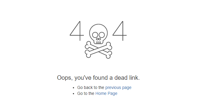

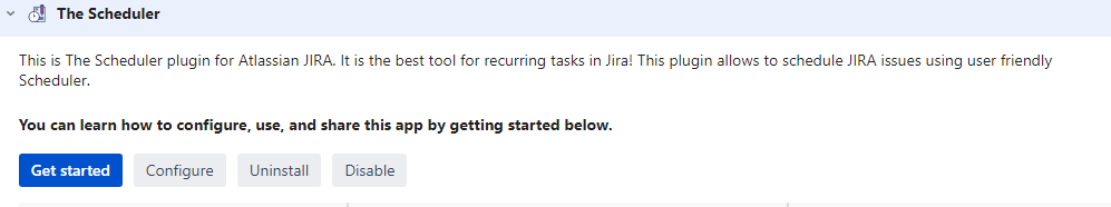

I installed the plugin both ways. After a long time, the plugin installed, but I encountered a 404 error in the configure section of the plugin. I have uploaded photos of the error as well. Can anyone help me with this issue?IMG_3027.pngIMG_3026.png

Hi @mahsa ah
Did you try installing the addon the following two ways?
1. Install using the OBR file
2. Install using the jar file downloaded from the marketplace (this should be performed after you shutdown Jira)
And if you did not already, try uninstalling the addon from the manage apps page and if it fails, verify if the file is present in the installed-plugins directory. If its present, remove the file and then try to install the plugin using both the above methods.
Try clearing plugin cache as well before executing each troubleshooting step.
Hope this provides some clarity!
