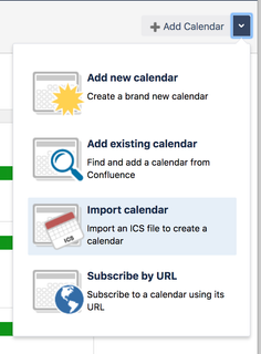

I would suggest going to each calendar individually on the old instance and follow this Export Process.
Then, on the new instance, click the arrow next to + Add Calendar and select Import calendar:
This will add the events to a new calendar.
Please note that it's not possible to merge calendars with this process, so you will need to create a new calendar.
