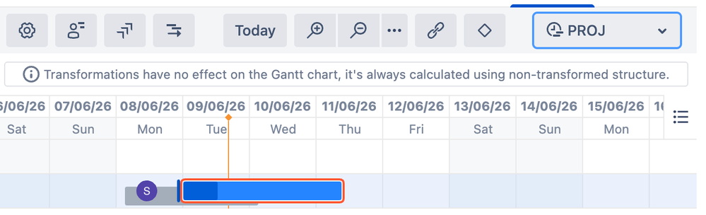

As a result, you should see something like this on the chart:
The blue bar will indicate the actual remaining work with the projected finish date. And the gray bar will show you when the work started. The finish date of the baseline doesn't matter in this case (it's only there because you need to define some Finish date for a baseline). You can set it as today() - this way, the baseline will be extending in time, too, which can look better (no visual gaps between the baseline and the bar).

Oh wow. My first use of baselines! while not exactly what I thought was achievable, this is what I want to be able to see. As I use this, I'm sure this view will be even better than I anticipated.
Thank you so much!
