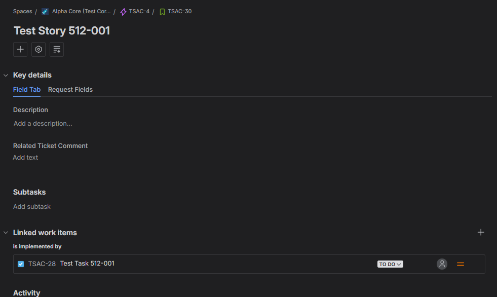

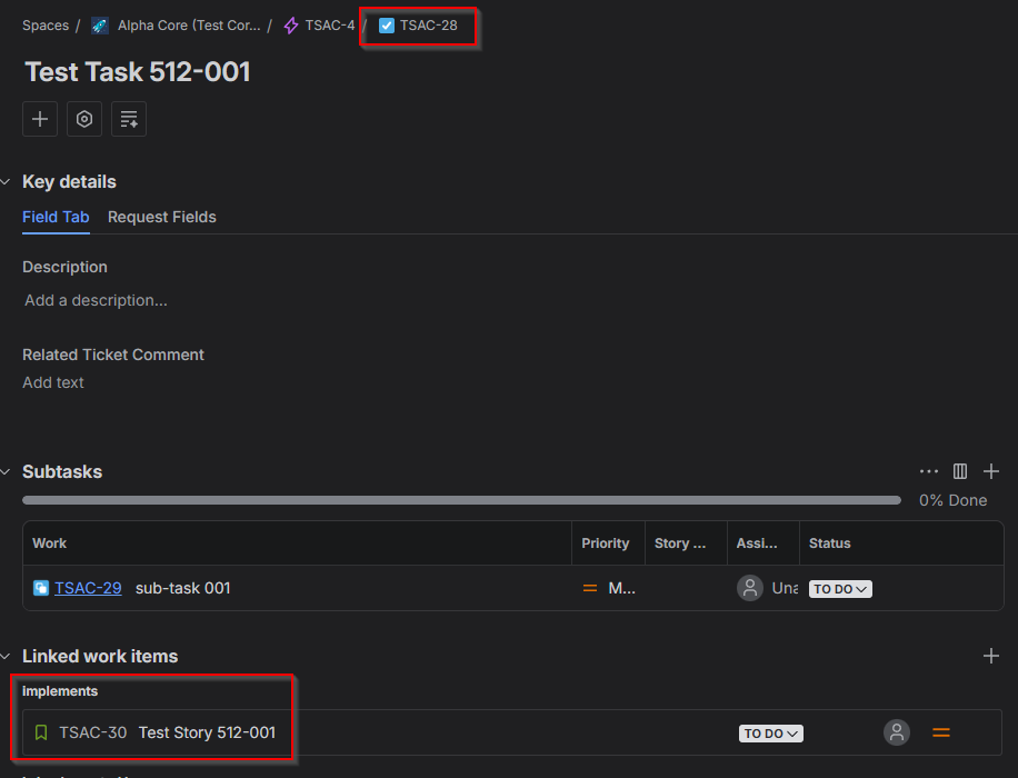

Context: I have an Epic that contains a Story. That Story is linked to a Task. The Story "is implemented by" the Task. The Task "implements" the Story.

The important thing to note that Task X's true parent in the Jira hierarchy is Epic 1 (Epic 1 is in the 'parent' field of Task X).

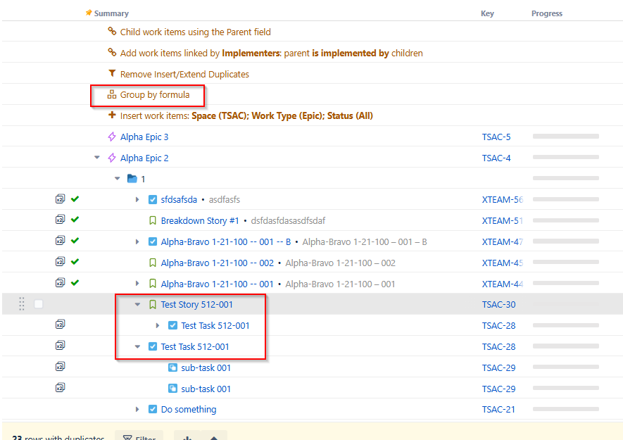

I have experimented at length with different generators. And re-ordering the generators where possible (it isn't always possible; Tempo will give you an error often that they cannot be reordered).
See the screenshot for the current state of said generators.
Problem: When the Structure renders, Task X is duplicated. It displays once because it is a child of Epic 1. And again because it "implements" Story A.

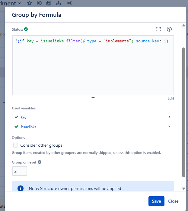

However, you can just filter out the direct children of an Epic, if they meet the defined criteria using the Formula grouper with a formula like this:
!(if key = issuelinks.filter($.type = "implements").source.key: 1)
and set its 'Filter on level' setting to level 2.
As a result, the formula will remove Tasks from under Epics if they have the 'implements' link towards other issues.

Thank you for the reply, although I added the suggested formula and did not see any difference. Task TSAC-28 implements Story TSAC-30. Story TSAC-30 has no "implements" link to any other ticket and has a parent of Epic TSAC-4. But even with the formula, I still see Task TSAC-28 twice, once nested under Story TSAC-30 and once nested under Epic TSAC-4. See screenshots.image.pngimage.pngimage.pngimage.png

Please note - the proposed formula is to be used in the Filter generator, not grouper.
But, regardless, there is definitely something off here. Is the name of the link type is 'Implements'? The Formula is not referencing the link direction that you see on the work item page('implements'), but it references the link type name which can, in theory, be something different. You can find it at Jira at settings | Work items | Work item linking. Check the name of the link type that has the 'implements'/'is implemented by' directions, and adjust it in the formula, if needed.
