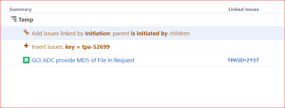

I would like to create a structure which shows the issues linked by a specific link type. Here's a simple example: TPA-52699 is initiated by TPASD-2137. I think the automation is correct, however, I still don't see TPASD-2137 under TPA-52699. Any advice is appreciated!

Hello @Martin Härri
Check the following:
1. There are no filter transformations enabled that can remove the linked issues.
2. The link and its direction configured in the Extend generator are correct.
3. The TPASD project is added to the projects with Structure list at Administration | Structure | Configuration. If a project is not added there, it won't be possible to add any of its issues to any structure.
I hope this helps. If you need further assistance, please reach out to our support portal.
