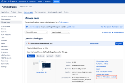

Hi @Elyse Grasso ,
Could you go to Jira Administration > Manage apps, and check the ScriptRunner plugin's modules to see if there are any disabled (like below)? If any, you may try enabling it then check if it helps.

Elyse Grasso
January 11, 2021
144 of 148 modules are enabled at installation
I was able to Enable two of them but scriptMacroMetadataProvider and 'Execute a ScriptRunner script action for Automation for Jira' cannot be enabled.
Items are still missing from Conditions and Validators menus.
