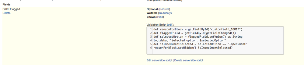

So, I was able to hide a field using this behaviour just fine. A few thoughts:
  1. Be aware that behaviours only function on the create/edit screen, and to a lesser extent things like workflow screens and similar views. Hiding fields from the View Issue page isn't really what they do. There is technically a beta feature to do that, but it requires converting fields to a particular type, which can be a bit dodgy.
  2. Are you doing this in an initializer? It should be a behaviour script on the Flagged field itself.

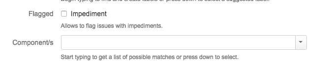

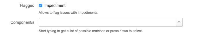

I am not trying to hide the field on the view screen (if it's empty it will not display) I am looking at the create and edit screens.
I have the text field hidden initially, but my expectation was that, on the edit screen, once I checked the Flagged field, the text field would then be displayed. This is where I am having issues.
If I could figure out how to add an attachment, I could show you what I am seeing

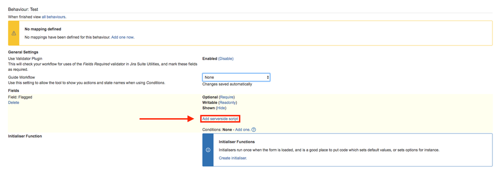

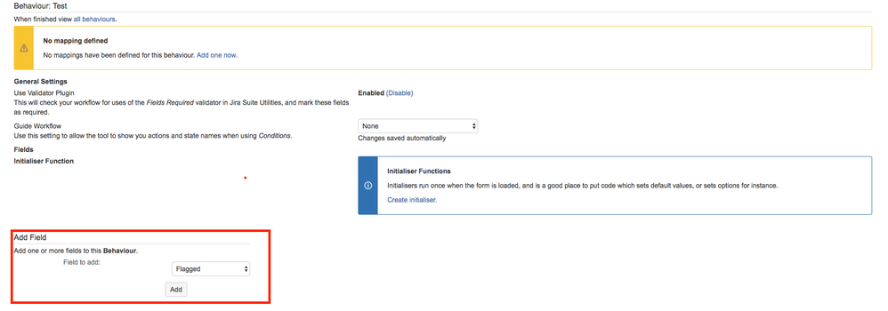

As Jonny mentioned before, you won't see the behavior that you are expecting if you have set up an initializer. An initializer should only run when the screen is first loaded and, therefore, a change to the form field won't be caught after its initial execution.
So instead, you should set up a behavior that is mapped directly to the Flagged field. I'll attach a couple of screenshots to help. Screen Shot 2017-06-19 at 11.09.24 AM.pngScreen Shot 2017-06-19 at 11.09.39 AM.png
