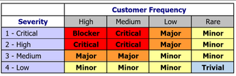

 I want to set priority using a severity-frequency matrix.
For ex : If the "Severity" field value is "1-Critical" and "Frequency" field value is "High", the Priority field should be changed to "Blocker".

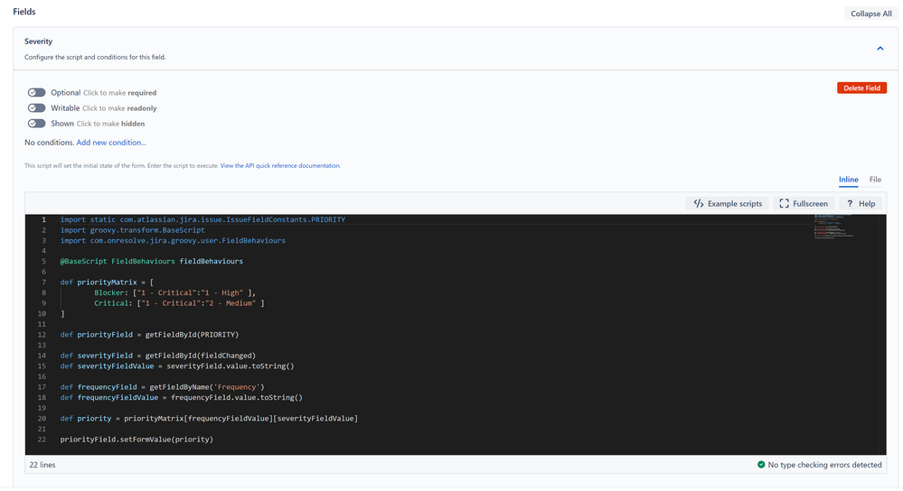

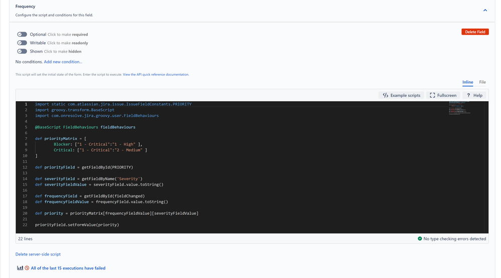

Hi @Ram Kumar Aravindakshan _Adaptavist_ ,
 Thank you for the quick response Ram!. Yes, I want to change the priority field based on these two fields "Severity" and "Frequency"
I added the two server scripts, but its not working. and see the error in the logs, and Please check the attached screenshots for your refernce.
2024-06-13T17:29:26,451 ERROR [behaviours.BehaviourManagerImpl]: *************************************************************************************
2024-06-13T17:29:26,452 ERROR [behaviours.BehaviourManagerImpl]: Script function failed on issue: (create issue) project/issuetype: TEST/Task, fieldId: customfield_34215, file: <inline script>, edit behaviour: plugins/servlet/scriptrunner/admin/behaviours/edit/4ccd5671-4e5a-4459-b313-ee75019cf021
java.lang.NullPointerException: Cannot get property '1 - Critical' on null object
at a8ade8bae77a6f0ae48bec5ea92e937a.run(a8ade8bae77a6f0ae48bec5ea92e937a.groovy:20) ~[?:?]

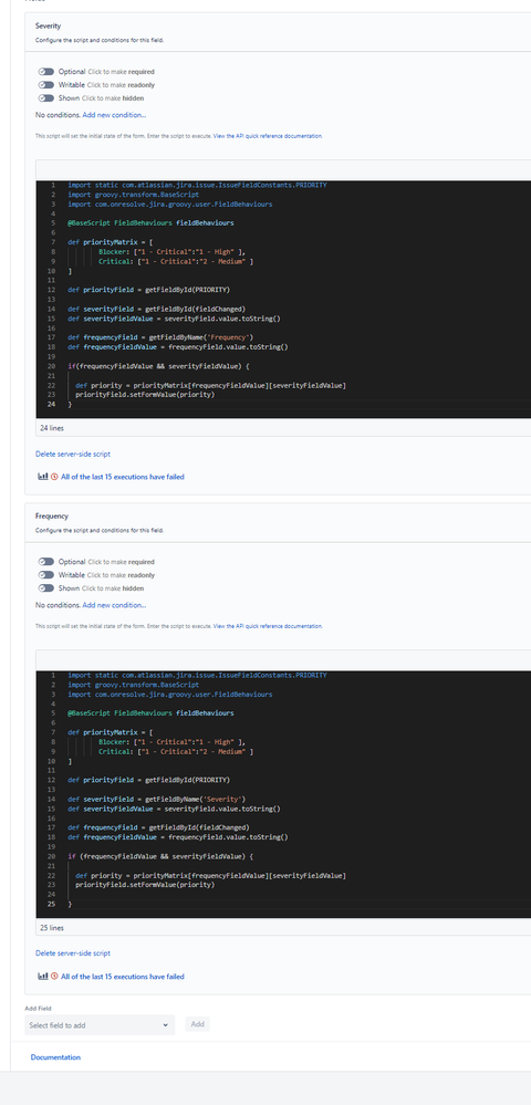

jira_admin_cu
June 14, 2024
 Sorry, I didn't see the comment under your suggested answer. Yes, I am filling up both fields before creating the ticket, but it's not working with your new suggested code either. Its showing same error in the logs.

jira_admin_cu
June 17, 2024
Here are the logs.
Severity :
2024-06-17T14:08:06,545 WARN [runner.ScriptBindingsManager]: ===============<<<<>>>> Priority Value: 4
2024-06-17T14:08:06,545 WARN [runner.ScriptBindingsManager]: ======================>>>>> Severity Value: 1 - Critical
2024-06-17T14:08:06,545 WARN [runner.ScriptBindingsManager]: ======================<<<<< Frequency Value null
2024-06-17T14:08:06,546 ERROR [behaviours.BehaviourManagerImpl]: *************************************************************************************
2024-06-17T14:08:06,548 ERROR [behaviours.BehaviourManagerImpl]: Script function failed on issue: (create issue) project/issuetype: TEST/Task,  fieldId: customfield_16003, file: <inline script>, edit behaviour: /plugins/servlet/scriptrunner/admin/behaviours/edit/4ccd5671-4e5a-4459-b313-ee75019cf021
at 4e6133b063a53bf811d4d685bf246b7d.run(4e6133b063a53bf811d4d685bf246b7d.groovy:26) ~[?:?]
Frequency :
2024-06-17T14:08:08,284 WARN [runner.ScriptBindingsManager]: ===============<<<<>>>> Priority Value: 4
2024-06-17T14:08:08,284 WARN [runner.ScriptBindingsManager]: ======================>>>>> Severity Value: 1 - Critical
2024-06-17T14:08:08,284 WARN [runner.ScriptBindingsManager]: ======================<<<<< Frequency Value 1 - High
2024-06-17T14:08:08,285 ERROR [behaviours.BehaviourManagerImpl]: *************************************************************************************
2024-06-17T14:08:08,286 ERROR [behaviours.BehaviourManagerImpl]: Script function failed on issue: (create issue) project/issuetype: TEST/Task, fieldId: customfield_34215, file: <inline script>, edit behaviour: /plugins/servlet/scriptrunner/admin/behaviours/edit/4ccd5671-4e5a-4459-b313-ee75019cf021
at 3c7c29f2e499144b8b79eed72064c20d.run(3c7c29f2e499144b8b79eed72064c20d.groovy:26) ~[?:?]
