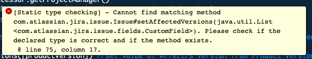

Thanks Peter, I tried that and still getting this error.
More of the code if it helps.

PD Sheehan
January 12, 2021
Ah the full context and screenshot really helps.
As you can see in the error, you are giving the setAffectdVersions a list of "CustomField" object. When you see to provide a Version object
Looking at the line where the ProductVersion is defined:
def productVersion = customFieldManager.getCustomFieldObject(11622) //Product Version
We can see that this is just defining the custom field object.
Perhaps try like this:
def productVersionCf = customFieldManager.getCustomFieldObject(11622) //Product Version
def productVersion = issue.getCustomFieldValue(productVersionCf)
Now, if you need the extract the product version from the linked issues and not the current issue, then you will need put the def productVersion inside the "each" block and use destinationIssue.getCustomFieldValue(productVersionCf).
You may still get a static type checking issue if the code editor doesn't know that List and Collection can be handled as the same at runtime, in that case, the error can be ignored. The real test will be the execution.

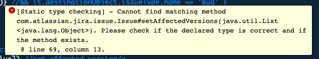

Hi Peter, I am back and have made some changes to clean up my code and verified that my code works if I want to leave a comment on a linked issue with the data from the custom field version picker. Sadly, I still am having issues populating Affect Version/s as I want though due to still seeing a static check error. I attempted to test even with the static check error and no such luck. I checked logging and no errors shown as well.

PD Sheehan
January 13, 2021
What type of customfield is your Product Version customer field (11622)?
Is that text,  Version Picker Single or Version Picker Multiple?
That will make a difference for how to apply the value to the built-in version field.
Casey Hinkle
January 13, 2021
It is a Version Picker Single custom field.
PD Sheehan
January 13, 2021
A few things to try
1) add import com.atlassian.jira.project.version.Version
2) add "as Version" when getting the productVersionValue
def productVersionValue = issue.getCustomFieldValue(productVersionCf) as Version
3) add "as MutableIssue when setting the linkedIssue:
def linkedIssue = it.destinationObject as MutableIssue
This makes all the static type error go away in my environment.
For additional debugging, you can try something like this:
linkedIssues.each {
log.info "Attempting to se the affected version on $linkedIssue.key to $productVersionValue which is an object of type ${productVersionValue.getClass()}"
linkedIssue.setAffectedVersions([productVersionValue]) //set affected version/s
log.info "$linkedIssue.key affectedVersion is now: $linkedIssue.affectedVersions"
Casey Hinkle
January 14, 2021
Thank you Peter that definitely helped and it no longer gives a static error. I can see in the logs it is attempting to now perform the requested actions, but is tossing an exception in doing so. This is progress as I now know it is at least attempting to set the version field Affect Version/s. Let me see if I can debug this some and check back, but you have solved my issue with the static check on setting the value.
