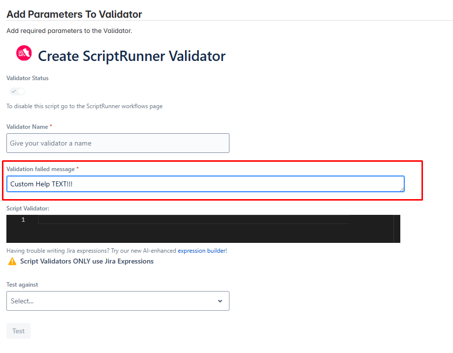

I want to give a customized error message also.
Validator does not offer this feature.
I have used validator for linked issue as well, but it's not showing customized message , user won't be able to identify the reason why getting this error message and for which field.
With the help of behaviour i want to set helptext, if possible ?

Evgenii
June 24, 2025
@Vikrant Yadav sure, you can add custom help text with SR validator.
There are 3 fields in validator:
- Name
- Validation failed message
- SR expression
Enter required text in Validation failed message and it will be shown on transition screen.

Vikrant Yadav
June 24, 2025
Thanks @Evgenii  Yep in my system also I have this option set validation failed message.
This works for my use case. Thanks a lot @Evgenii
