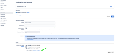

If you go into the Behaviour configuration page you should be able to click the "add a new condition" link to add a condition as you can see from the screenshot below :
From there you can add several new conditions. You can also add server-side script alongside those conditions. You should be able to see the "add server-side script" link on the same page as well.
