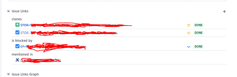

Can you share screenshot of both issues links configuration?
@Martin Bayer [MoroSystems, s.r.o.] The first screenshot is from the BLOCKED issue and second is the one is DONE.

Hi @Paulina Mijal I just creatd testing data on my instance and it works as expected. What version of Jira and Script runner do you use? Can you Reindex your STOR project?
Sorry, I have only older version of Jira available to test it. Can you try to reindex STOR project?
@Martin Bayer [MoroSystems, s.r.o.] What does the reindexing? How this affects to the project and on the entire system?
@Paulina Mijal Index is "file" which is searched when using JQL. Reindexing process will update the index with current data on issues. More about reindex can be found here: https://confluence.atlassian.com/adminjiraserver/search-indexing-938847710.html
