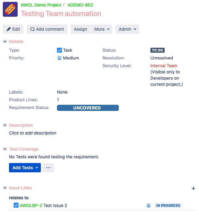

EDIT: Unfortunately I now understand why you were using outward instead of inward. Unfortunately, although the link and link type appears to exist, it fails when collecting with the following error:
java.lang.AssertionError: No linked issue of type Relates were found. Expression: listOfProjectKeys. Values: listOfProjectKeys = [] at org.codehaus.groovy.runtime.InvokerHelper.assertFailed(InvokerHelper.java:417) at org.codehaus.groovy.runtime.ScriptBytecodeAdapter.assertFailed(ScriptBytecodeAdapter.java:670) at Script1645.run(Script1645.groovy:27) at org.codehaus.groovy.jsr223.GroovyScriptEngineImpl.eval(GroovyScriptEngineImpl.java:317) at org.codehaus.groovy.jsr223.GroovyScriptEngineImpl.eval(GroovyScriptEngineImpl.java:155) at java.scripting/javax.script.AbstractScriptEngine.eval(Unknown Source)
As you can see below, there is at least one link present on my test issue and I have updated the link type to "Relates" to reflect this:
For some reason, getting these links in a meaningful way is my kryptonite. Sincerely appreciate all the help so far!
