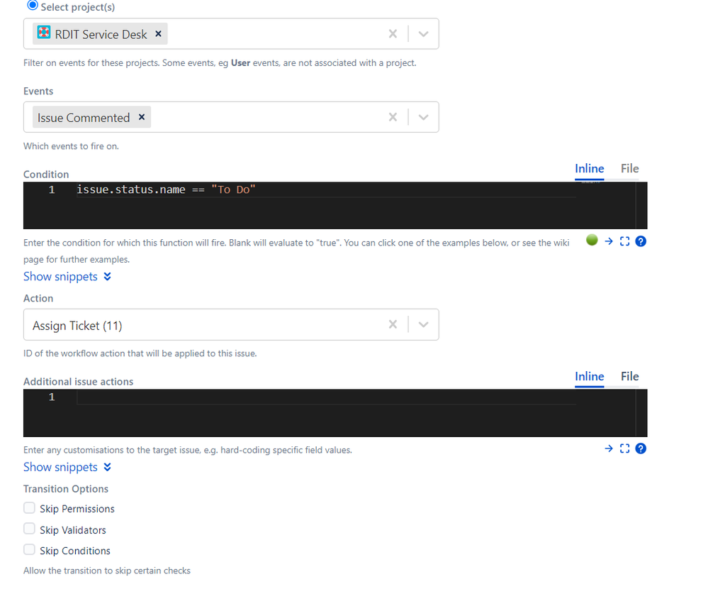

Hi Ram,
Here's my listener configuration

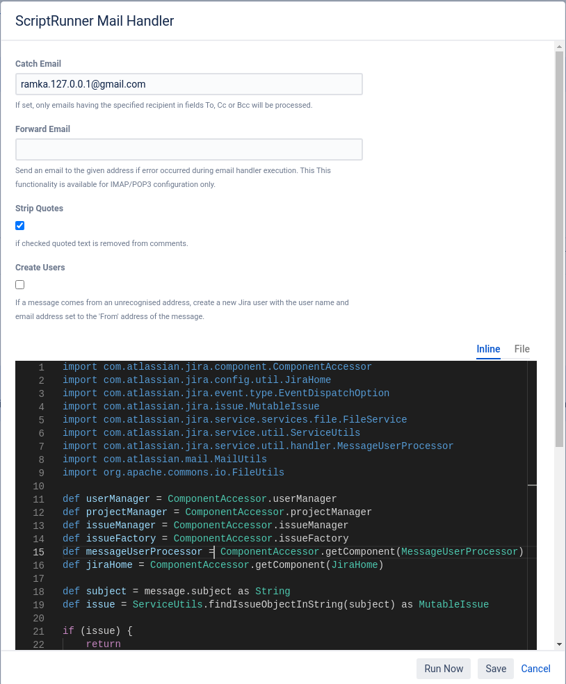

Below is a screenshot of my mail handler configuration:-
Below is the sample code that I have tested with:-

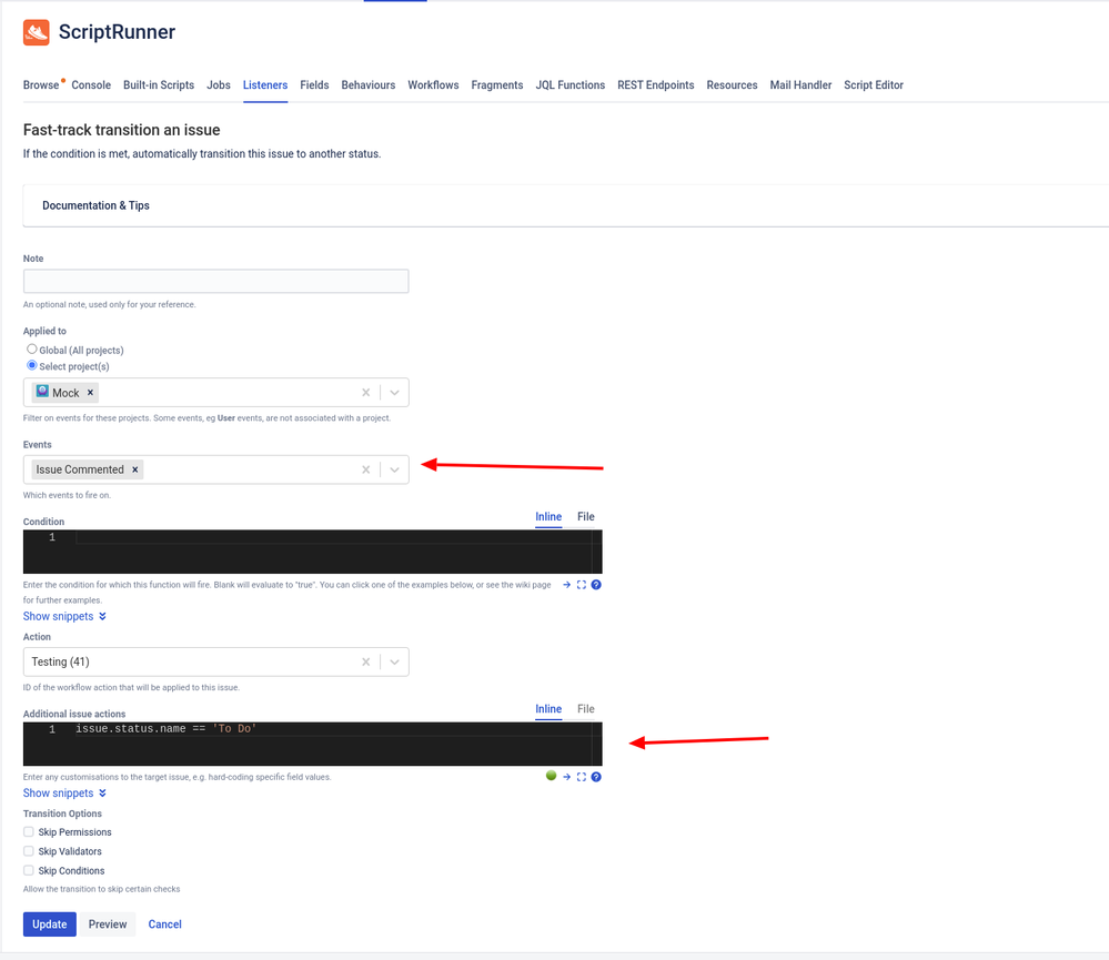

For the Listener, I am using the same configuration that you have shared, i.e.:-
Below are a few test screenshots for your reference:-

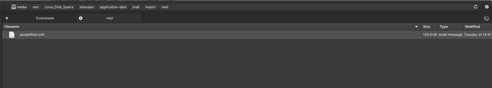

1. The email file is added to the <JIRA_HOME>/import/mail as shown below:-

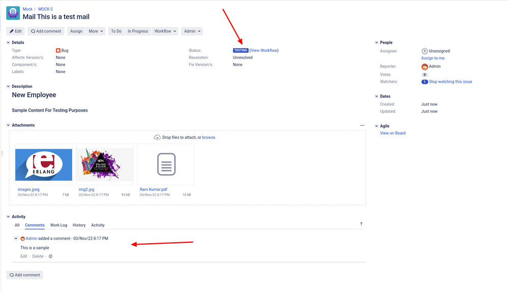

2. Once the mail handler is executed, the mail folder is cleared, and the issue is created, as shown below.
If you observe, the issue is created with attachments and can transition to the Testing status without any issues.
