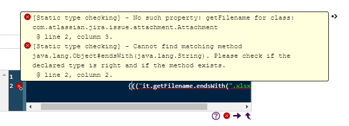

I want restrict attachment type in creating issue(when creating issue must be attach ONLY excel File in "creat issue screen").I writed this script, but there are error in it.
How can I fix the problem?
Can this code be a solution??
attachmentManager.getAttachments(issue).each
{(it.getfilename.endsWith(".xlsx"))}
Thanks
Marzi

Hello,
What is the error?
Marzi Goodarzian
December 25, 2017
Alexey Matveev
December 25, 2017
It shoud be like that
{(it.getFilename().endsWith(".xlsx"))}

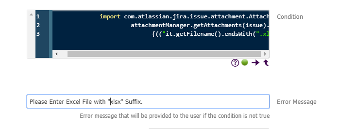

Marzi Goodarzian
December 26, 2017
Thanks @Alexey Matveev
Code error resolved, But any File(even excel file with xlsx Suffix) attach in Create screen , Displays an Error Message in create issue and issue dont create.
How do Resolve it?
ٍErroe message is in script validator screen.

Marzi Goodarzian
December 26, 2017
I run this code but the error message is still displayed and issue is not created.
