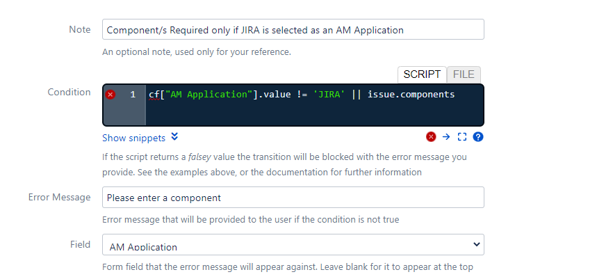

@PD Sheehan Unfortunately the simple scripted validator didn't work. I also ended up having to change my custom field name from Atlassian Platform to AM Application.
Sorry... I was sloppy. It should be "cfValues", the built-in variable that scriptrunner offers that includes all the custom field values in an easily accessible map.
cfValues["AM Application"].value != "JIRA" || issue.coponents
Bummer, still not working. I tried with both single quotes and double quotes.
cfValues['AM Application'].value != 'JIRA' || issue.coponents
I was clearly under-caffeinated yesterday ... there was another typo: coponents vs components
cfValues["AM Application"].value != "JIRA" || issue.components

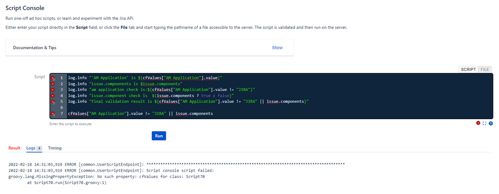

Can you share some more details? Are there any errors in the script editor?
Do you see errors in the execution log (open the workflow/transition after executing the transition to view execution logs).
Maybe we can add some additional logging to help with identifying where it's failing:
log.info "'AM Application' is ${cfValues["AM Application"].value}"
log.info "issue.compoenents is $issue.components"
log.info "am application check is:${cfValues["AM Application"].value != "JIRA"}"
log.info "issue.component check is ${issue.components ? true : false}"
log.info "final validation result is ${cfValues["AM Application"].value != "JIRA" || issue.components}"

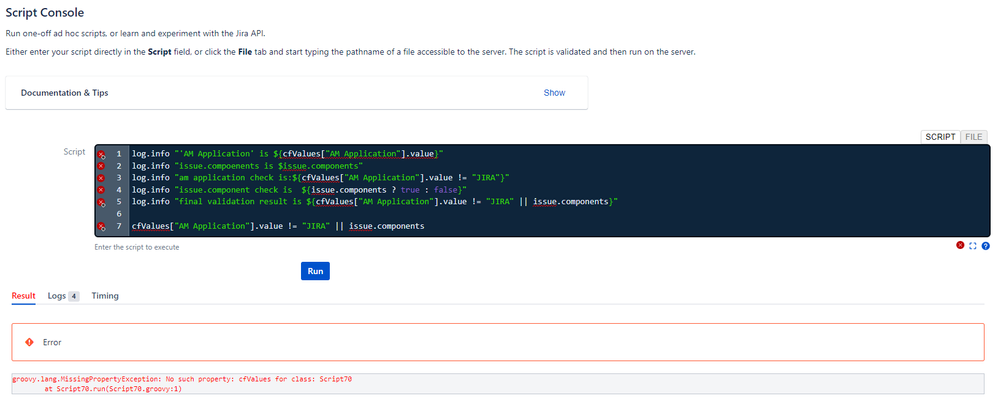

Here's a screenshot of the results and logs. Also, shouldn't it be == "JIRA" instead != "JIRA" because I only want Component/s field to be required if JIRA is selected.
The script will not work in the Script Console.
In a simple scripted validator script editor window, there will be some built-in variables and objects (you can see which by clicking the question mark below the editor).
issue and cfValues is two of those variables.
These variable are not available in the console since it's not aware of what ticket you want to act on etc.
As for the logic for the selected value... you want to return a "true" value (i.e. allow the transition to continue) either when the AM Application is something OTHER than Jira, OR if they've selected JIRA, then the components must be specified.
The way an OR (||) is processed, is that it will return true at the first instance that is true.
So from left to right, the first statement evaluated will be "AM Application" different than JIRA. If true, then return true and allow the transition. If False (AM Application IS JIRA) then evaluate the next statement.
Groovy has "thrutiness" shortcuts. So here, we are essentially validating that issue.components.size() > 0.
So, the final rule is, when AM Application is JIRA at least one component must be present.
