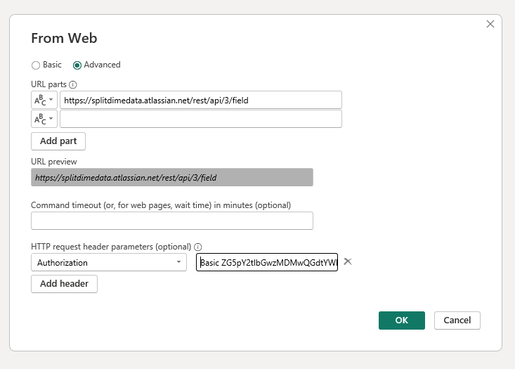

Good morning -- I think I can help.   I use the REST APIs to pull data into Power BIwithout any additional plugins.  Here is a link to a "Work in Progress" Power BI Report that pulls data from ecosystem.atlassian.net daily (for test data purposes)
https://app.powerbi.com/view?r=eyJrIjoiMWIwNzk5OGMtOGFmNS00NmIzLWE1YzUtN2M2MjZiNDgyNmU2IiwidCI6IjNjZDVhOTg1LTBkM2YtNGM0ZC1hY2M1LTU2NTlhMTJiMTEyMyJ9
If you want to add a single API Endpoint to Power BI, here is one method.
  1. Use a WEB Connection formatted as I show below
  2. Include an  AUTHORIZATION HEADER with your Base64 encoded API Token
  3. When prompted for permissions, you will connect ANONYMOUS using ORGANIZATION privacy levels

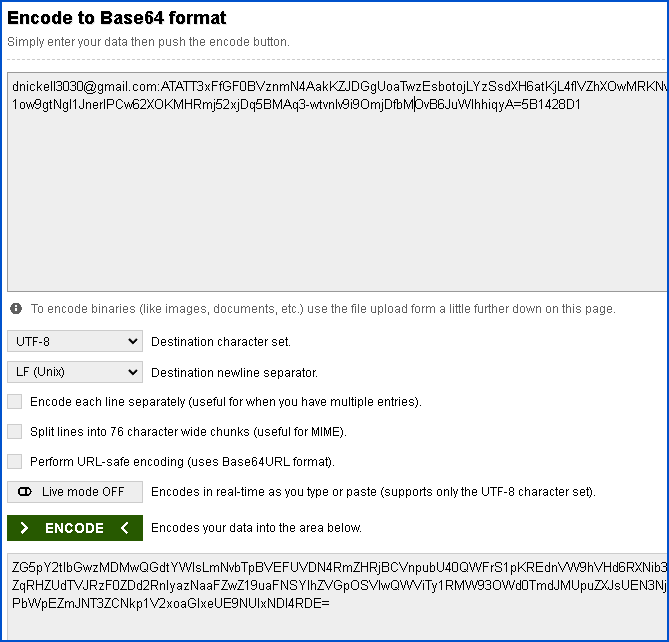

To get your encoded Basic API token, you can:
  • create an api token at https://id.atlassian.com/manage-profile/security
  • Encode your user id (email address) + a colon + your token.  You cand do this at Base64Encode.com
  • Then add the word Basic, a space, and your encoded token to an authorization header.
I've included some screen shots. Let me know how this goes.
NOTES:
  1. the format of "email:token" is extremely important when you encode.  The format of "Basic encodedtoken" (with a space) is also important
  2. Once you get the basics down, you can build reusable functions to use for all of your endpoints.  The example I provide here is very basi
Your data source will look like this:
encoding at Base64Encode.com will look like this:
