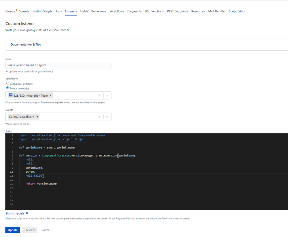

I would my listener on the sprintCreatedEvent to only be triggered on a certain project. Currently the script below creates a version in a project when there is a sprint created in every project.
{code}
import com.atlassian.jira.component.ComponentAccessor
import com.atlassian.jira.project.Project
def sprintName = event.sprint.name
def version = ComponentAccessor.versionManager.createVersion(sprintName,
    null,
    null,
    sprintName,
    16400,
    null,false)
    return version.name
{code}

Hi @Atlassian TMG
Could you please share a screenshot of your listener configuration? I am requesting this to check if you have specified the projects you want the listener to work on in the configuration.
I am looking forward to your feedback.
Thank you and Kind regards,
Ram
