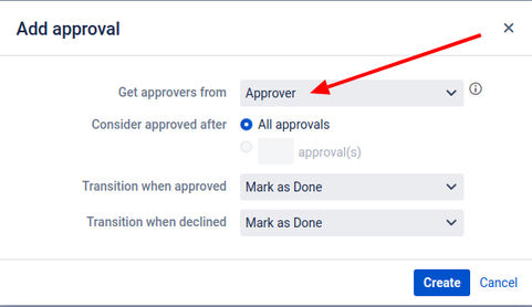

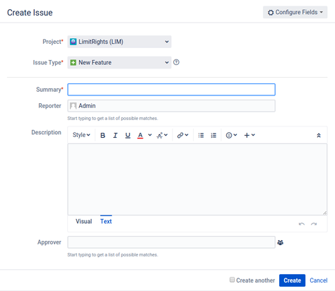

1) Add a custom field -  for example a Single User Picker.  The Print Screen Below I've added the Approver field which is a Single User Picker.
2) Configure the workflow and set the approver.  In the print screen below, I'm choosing a In Progress and setting the Add Approval option.
3) Next select the configuration and set the field in which you want to display the approvers.

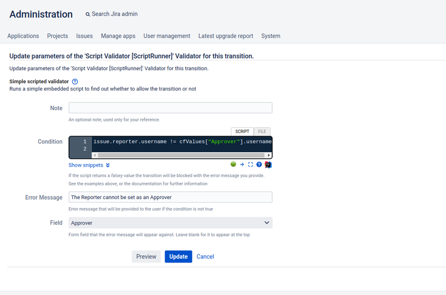

4) Once that is done, you will need to add a new validator into the transition.   To add the validator,  select Script Validator [ScriptRunner] -> Simple Scripted Validator
Below is a sample code that I have used
issue.reporter.username != cfValues["Approver"].username

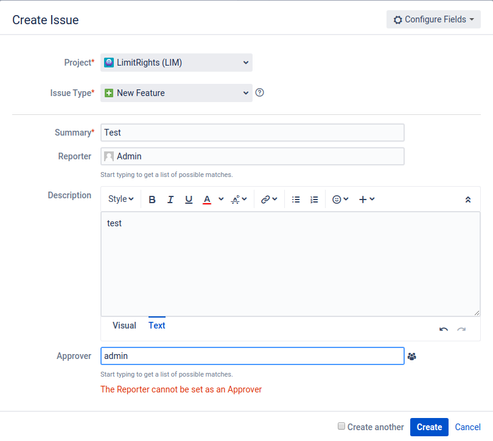

The field that I am setting this for is the Approver field.  Below is a print screen of my configuration.
So now, when I create a new issue for this project, if the Reporter and Approver are the same, the ticket will return a message and cannot be created.
Below is a print screen of the validation
Hope this helps :)

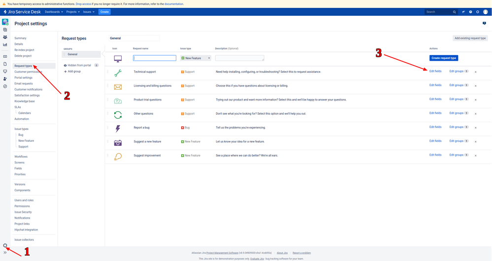

Go to the project.
1) Select the project's cog.

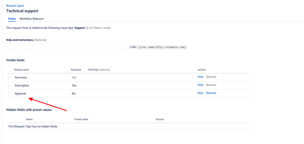

2) Next, select Request types.
3) Either add a new Request type or modify your existing Request type as shown below.
Make sure that the field you want to use is included in the Request Type as shown below:-

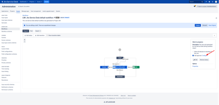

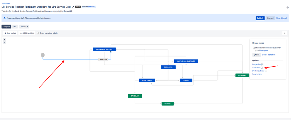

Next, you will need to modify the workflow slightly.
As shown in the print screen below, you will need to add a validator for the create transition.
You can use the same example I provided in my earlier comment i.e.
Once this is done you can start to test it.

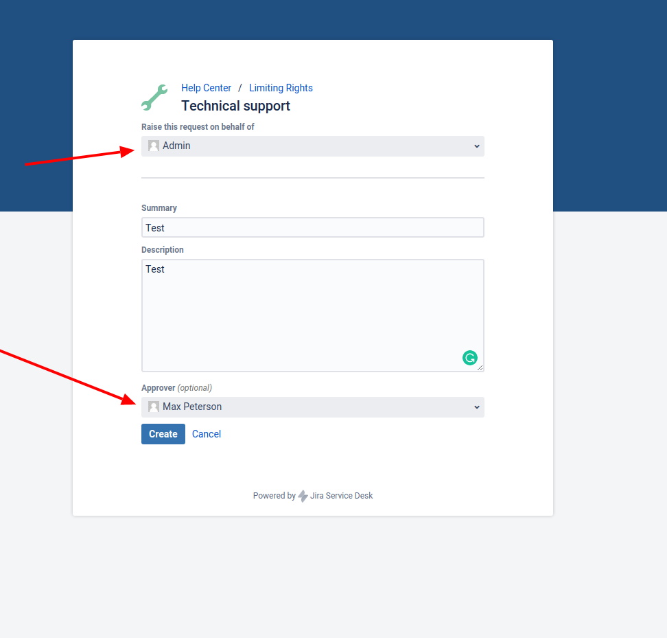

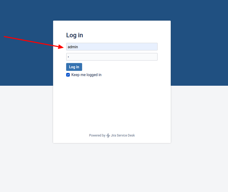

1) First login as shown below and select the project you want to use. In the example below I am logging in as an Admin user.

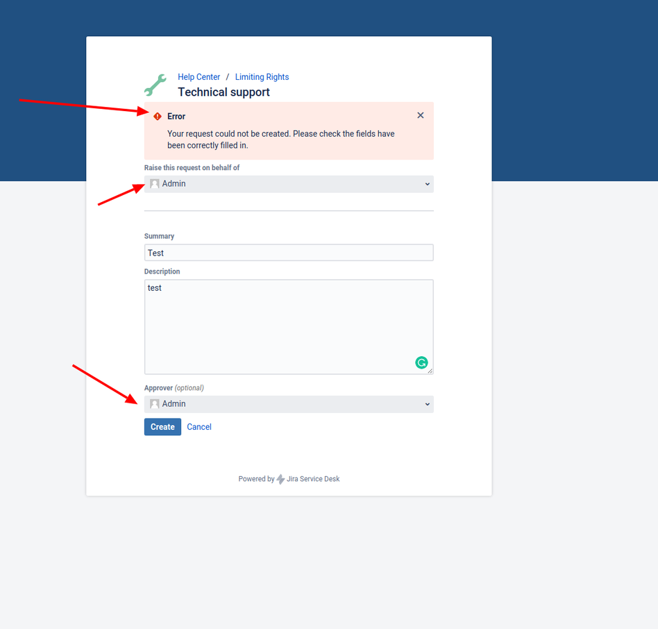

2) Next, create a sample ticket and select the approver as the same user you log in as.  In the print screen below, I have logged in as the Admin, and I have also selected the Admin as the approver.  When I try to create the ticket, the Error message is displayed.
3) Next, I try to create the ticket once again, but this time instead of selecting the Admin (logged in user) as the approver I have selected another user test_3.png

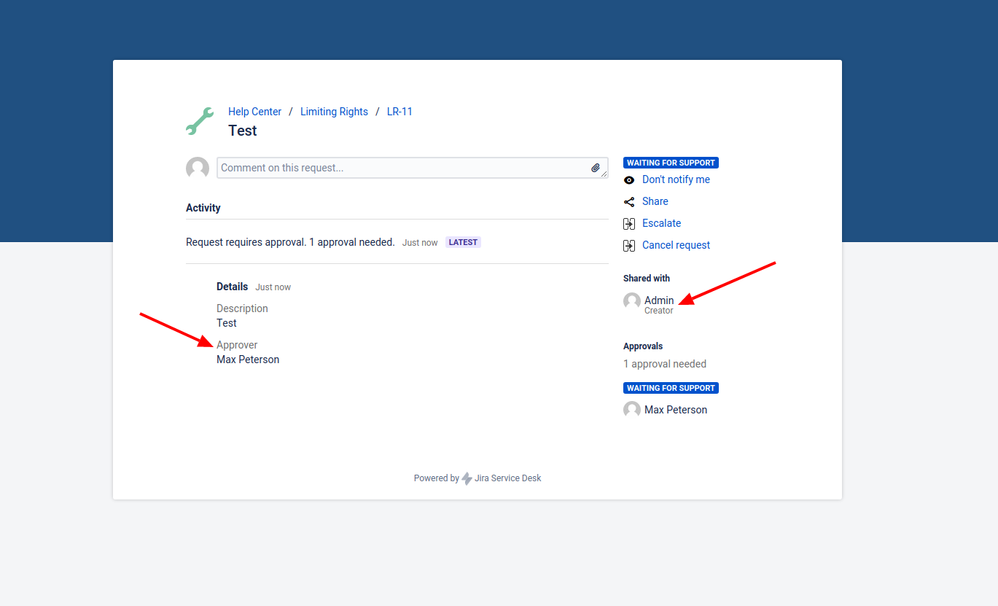

Hope this helps to answer your question :)

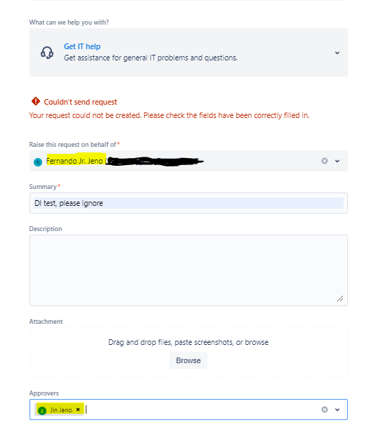

Hi @Ram Kumar Aravindakshan _Adaptavist_
I have tried your solution and steps above but it still does not work for me.
We have an "Approvers" field which is a user picker (multiple users). And I tried to insert this script as mentioned in your steps:
issue.reporter.username != cfValues["Approvers"].username
However during testing, it still does not work.
