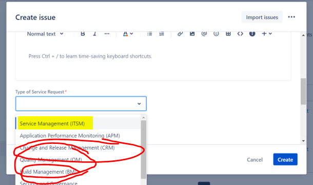

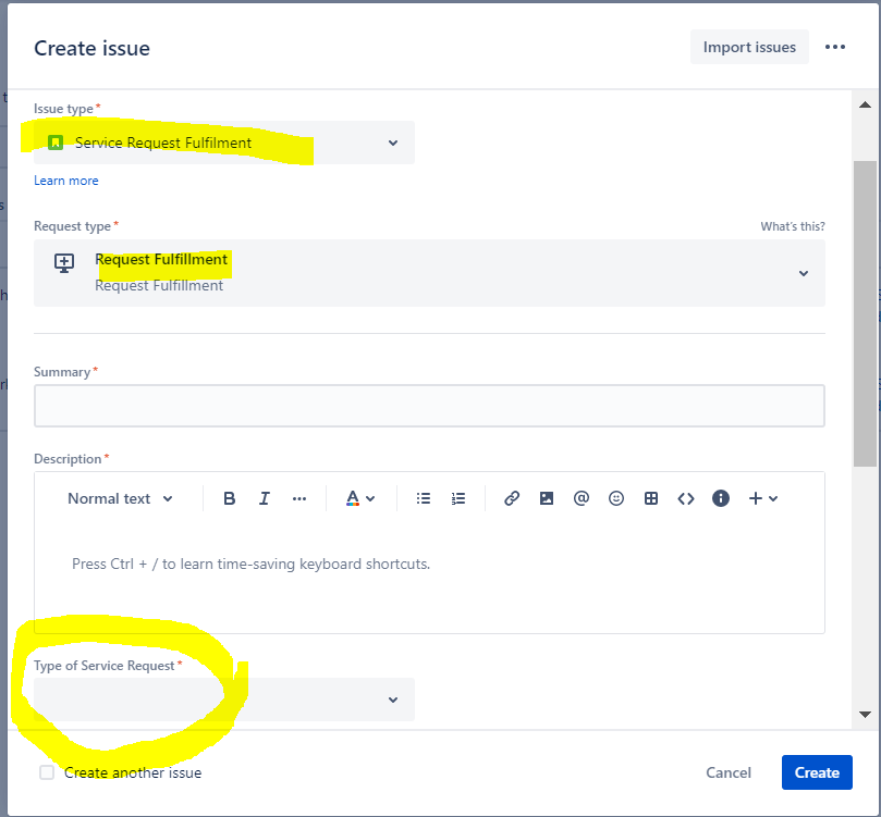

Hi,
In Issue Type: Service request and Request type: Request Fulfillment
I have field called Type of Service Request(Drop down) : ITSM
                                                                                              QA
                                                                                               Security and Compliance
                                                                                               Development
If i select ITSM and Create a Request then workflow will follow 2 levels of approvals which are Manager and System Owner simultaneously.
If i select QA(or)Security and Compliance(or)Development-------and Create a request then the workflow will follow 1 level approval which is only Manager approval.
Is it possible in Jira can we implement such a workflow. if yes kindly suggest me the steps to implement the same.
Ste Wright
December 28, 2022
Hi @Sreenadh
Can I confirm the logic here?
  • When an Issue is created...
  • If...
    • Type = ITSM
    • Then Approvers = Manager, System Owner
  • Else-If...
    • Type != ITSM (or various options)
If yes, it's possible - but does depend on whether the "Approver Source" is the same for both If / Else-If.
If Source is the same (for example, the "Approvers" field)...
  • You could control this using Automation Rules
  • The rule would need to check what the value of "Type of Service Request" is, then populate the "Approvers" field appropriately
  • The Approval Rules in the Workflow should require "Everyone" to approve the request
If Source is different...
  • This is more complex, as "Approver Source" can only be a single value per Status in the Workflow
  • Then I'd recommend...
    • Create a new Workflow, with a non-Approval Status first
    • Create two "Waiting for Approval" Statuses - one for each scenario
    • Set the appropriate Approval rules per Status (Approval Source, etc)
    • Use Automation at Issue Creation to decide which Approval Status is relevant
    • Transition all issues using Automation into the relevant Status at creation
Let us know which option is preferred - and if you need any additional instructions to integrate these!
Ste
