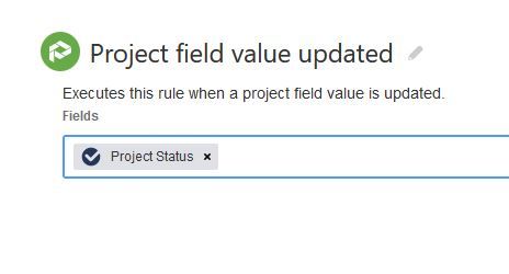

Maahshid Vaziri August 9, 2022
It is cotumefield I attached Screenshot,
PD Sheehan
August 9, 2022
I am not familiar with the app that provides this project-level custom field.
I think it's not important or key point of my work, because automation rule find this costume field and run script, so now my question  :
in script how can I return project key and then read costume field?
