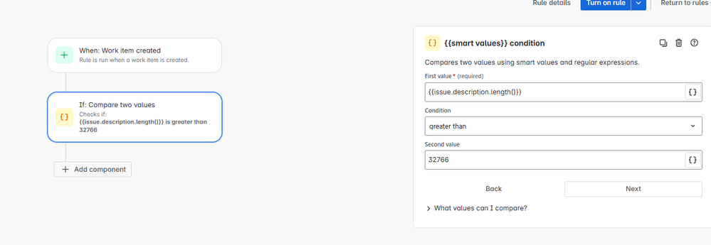

In automation you can make use of Smart Values to verify the lenghth of your description before executing the rest of your automation.
In this example, we would be using the smartvalue {{issue.description.length}}, which you can learn more about here->  Java documentation: Length
You rule would work the same as it was before:
Trigger: When field is edited [Description, during issue creation]
Conditional: Smartvalue condition-> If the issue description is smaller than 32767.
We use 32767 as it is the max character limit for a JIRA comment.
This way your rule won't execute in case of a character excess! Let me know if that helped!
