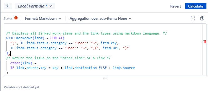

Laura Pellizzari
October 20, 2025
Hi @Gor Greyan
thanks for your support, can you please suggest how to correctly accomodate the central part:
other(link) =
IF link.source.key = key : link.destination ELSE : link.source
mark down.jpgwhen added the system does not recognize the variable anymore and it does not give any result.
thanks a lot
Laura
Gor Greyan
October 20, 2025
Hi @Laura Pellizzari
Thanks for the follow up:
Please try this one
WITH markdown(issue) =
CONCAT(
IF issue.status.category = "Done" : "~", issue.key,
IF issue.status.category = "Done" : "~", "](", issue.url, ")"
/* Return the issue on the “other side” of a link */
other(link) =
workItemLinks
.FILTER(other($).project.key = "ABC")
.GROUP(IF $.source.key = key : $.type.outward ELSE : $.type.inward)
.MAP(CONCAT($.group, " ", $.elements.MAP(markdown(other($)))))
If you prefer to filter by project name instead of key, change the filter line to:
.FILTER(other($).project.name = "My Project Name")

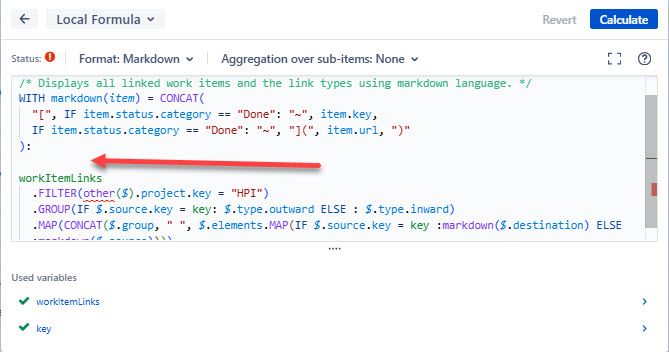

Laura Pellizzari
October 20, 2025
Thanks, please have a look to the screenshot, I think the problem is in the middle part:
Gor Greyan
October 21, 2025
Hey @Laura Pellizzari
Yes, you closed the WITH block too early.
The colon : after CONCAT(... ) ends the WITH, so other(link) is parsed as the main expression → error.
Add a comma after the first definition and keep one single colon only at the very end of the WITH block.
Also use single equals =, not ==, in Structure formulas.
WITH markdown(item) =
CONCAT(
IF item.status.category = "Done" : "~", item.key,
IF item.status.category = "Done" : "~", "](", item.url, ")"
other(link) =
workItemLinks

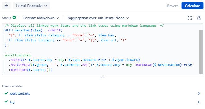

Laura Pellizzari
October 21, 2025
Hi,
I did everything you report above with no result..
Below is the original Formula for generic Linked Issue column already present in Structure as default, that works and display all the linked issues. this is the one I am trying to modify to have it displayed only linking to my specific project
thanks
Laura

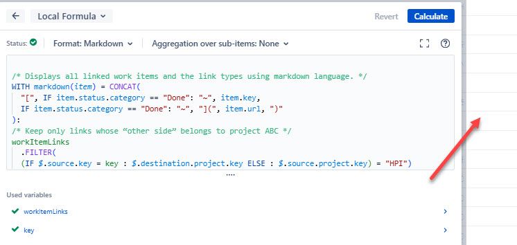

Gor Greyan
October 21, 2025
@Laura Pellizzari
Sorry, and thank you for follow-up.
Let's try this one.
/* Displays all linked work items and the link types using markdown language. */
WITH markdown(item) = CONCAT(
"[", IF item.status.category = "Done" : "~", item.key,
workItemLinks
/* Keep only links whose “other side” belongs to project ABC */
.FILTER(
(IF $.source.key = key : $.destination.project.key ELSE : $.source.project.key) = "ABC"
IF $.source.key = key : markdown($.destination) ELSE : markdown($.source)
Laura Pellizzari
October 23, 2025
Hi, the formula now does not give error, but it doesn't display anything on the column where it should be expected.
thanks
laura
